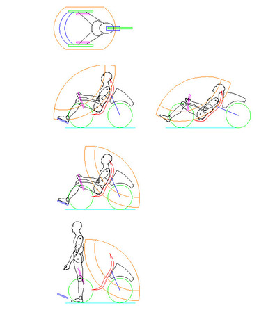

the problem is in the case of frontal crash, the leg of the driver will be the fist thing which will suffer. And of course back wheel steering bad idea, because it cause oversteer, or you preffer to drive only with small speed
For protection legs it will be obligatory a frame in front. On a condition of competition - the main thing is maneuverability for parking, not a high speed, also check up Sidewinder Cycle
