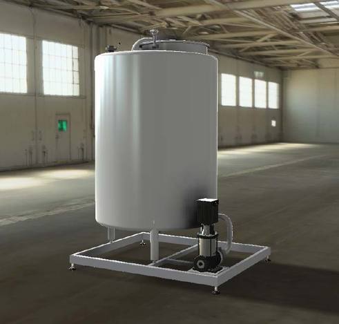

Simple 1500 litre round water tank with pump. Stainless steel skid mounted. Grundfos pump.
If you're going to produce, check the frame, it will sag without support in the middle, ogpor should be six, I stalknulsya the same problem and had to put extra support.
Thanks Mark, I will double check. What does 'ogpor should be six' mean?
