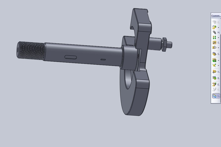

Yes right, this is a good function model of Wright engine. I'll set up most detaljs here.
The weakness with a two piece crank is there. Yet how else to deal with a connecting web that would have its' own weakness if split?
It has been manufactured many engines of this construction of the crank, which is machined from one piece, without any problem.
