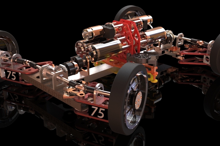

Ackermann steering drivetrain
An experimental drivetrain that steers with both the front and back sets of wheels. It also utilizes a 6 motor single speed gearbox and 2 window motors to control steering.

    This is an awesome design. Would love to see it in action in the 2013 competition season. If it is not already on Chief Delphi, you should post it. Great Work!

    Making the center of the tire closer to its pivot would also reduce the amount of wheel-well space required. I'll be looking forward to further updates to this model! Nice work.
