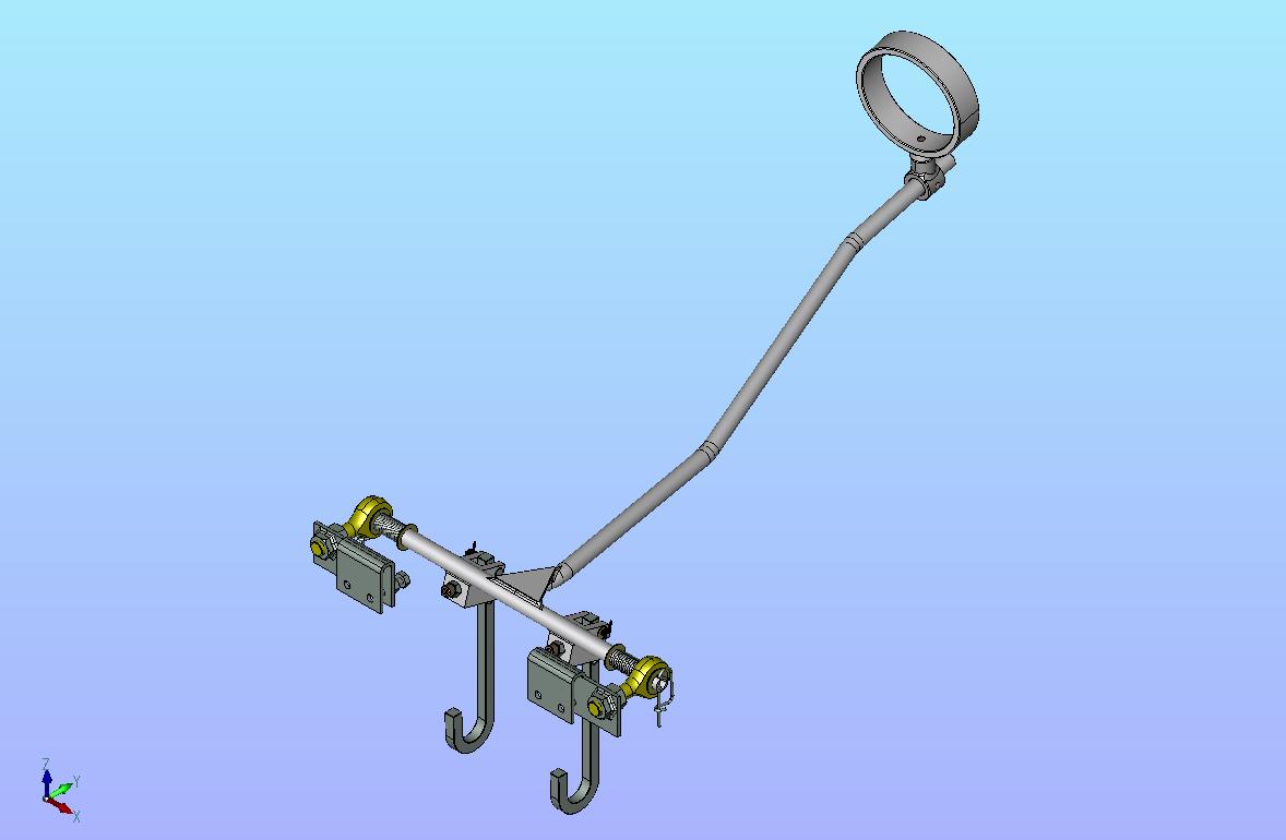

This allows disabled pilots to control rudder input using their hands. It was designed for the Cessna 172 & 177 models but can also be used in the C150/152 series. (Provided they have the cast, "flat top" rudder pedals.) I've also been told it will work in some Grumman models. Though I do not have 1st hand knowledge of that.
I should also mention, for those not aware, that FAA approval is required to use these in any certified aircraft. That approval would be in the form of either a Supplement Type Certificate (STC) or a 337 "Field Approval".

      These controls used to be made by Union Aviation, in Sturgis Kentucky. I paid about $600, back in the late 90's, for mine. And that included all the necessary paperwork, including the Cessna 172 & 177 STC's.
      Unfortunately I don;t think Union is making them any longer. I had conact with Mike Smith, president of the International Wheelchair Aviators, anf I know there are others looking to buy a set. They, and myself, have tried contacting Union Aviation, without any success.
      So I took measurements of my set, and modeled them in CAD. I'm working on a set of deimensioned drawings, but have not got them done yet. when I do finish them, I'll make them available (no charge) so people can build their own set. However, they will have to apply to the FAA for their own STC, in order to legally use them in a certified aircraft. (No STC needed for experimental homebuilts.)
      In the meantime, get a hold of the IWA (http://www.wheelchairaviators.org/) for more information about disabled flying. (Mike Smith is also a paraplegic.)
      I would also suggest you contact "Able Flight" (http://www.ableflight.org/). They provide flight training, and have scholarships available, for the disabled. they may also be able to help you.

      Very Nice Michael, these will be perfect for a homebuilt. Is the material primarily C4130 steel ?

      Hi Peter. I can't be sure, but I assume they're made from 4130. I think they would work with a number of homebuilts. Provided they don't interfer with any of the other controls. I've looked over few of the factory made LSA's, a couple years ago, and I think they could be modified to work with them as well. However, you would need approval from the aircraft manufacturer to be legal. (And I couldn't get it for the specific model I was interested in.)
