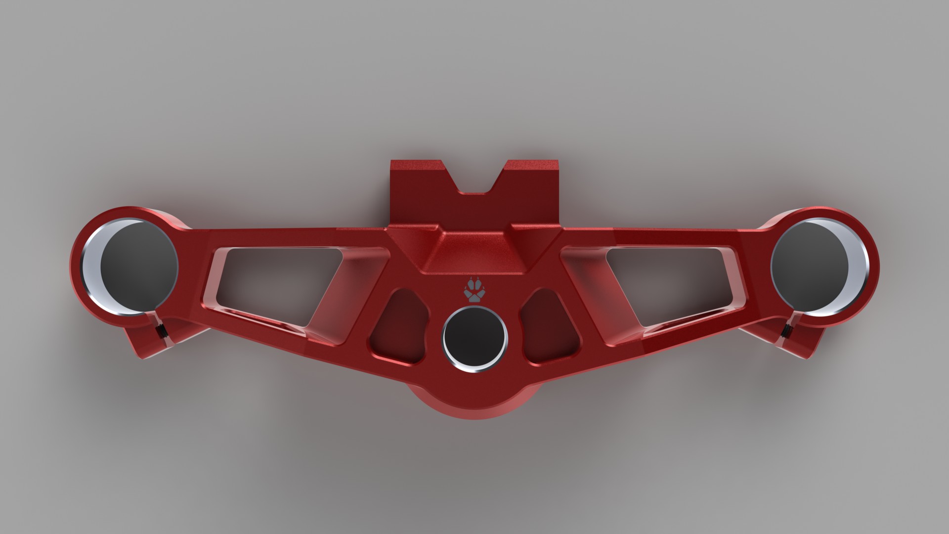

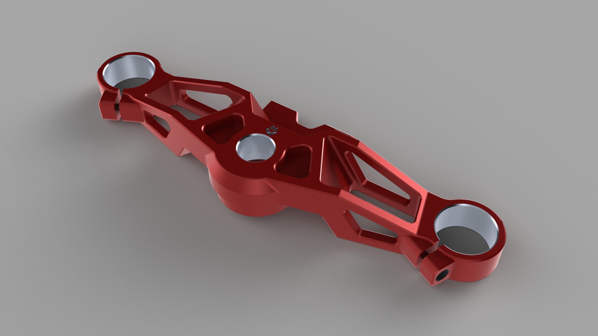

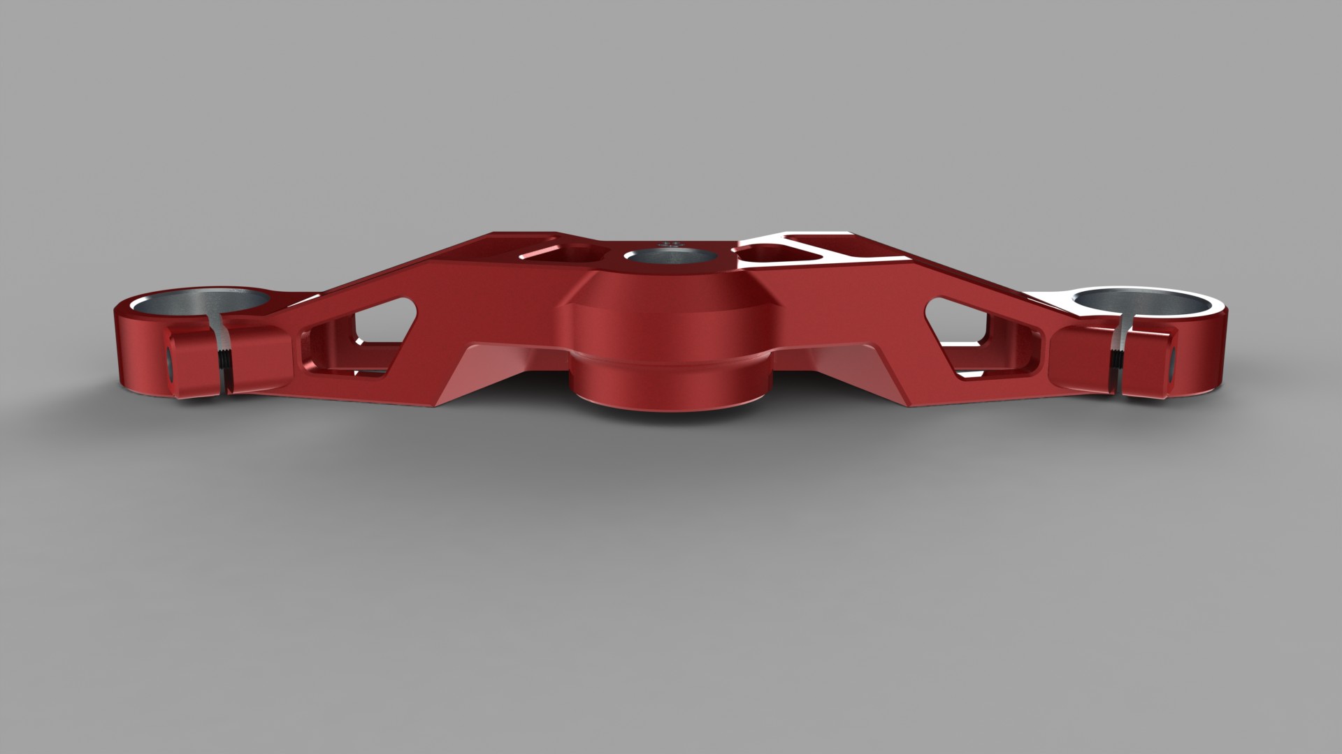

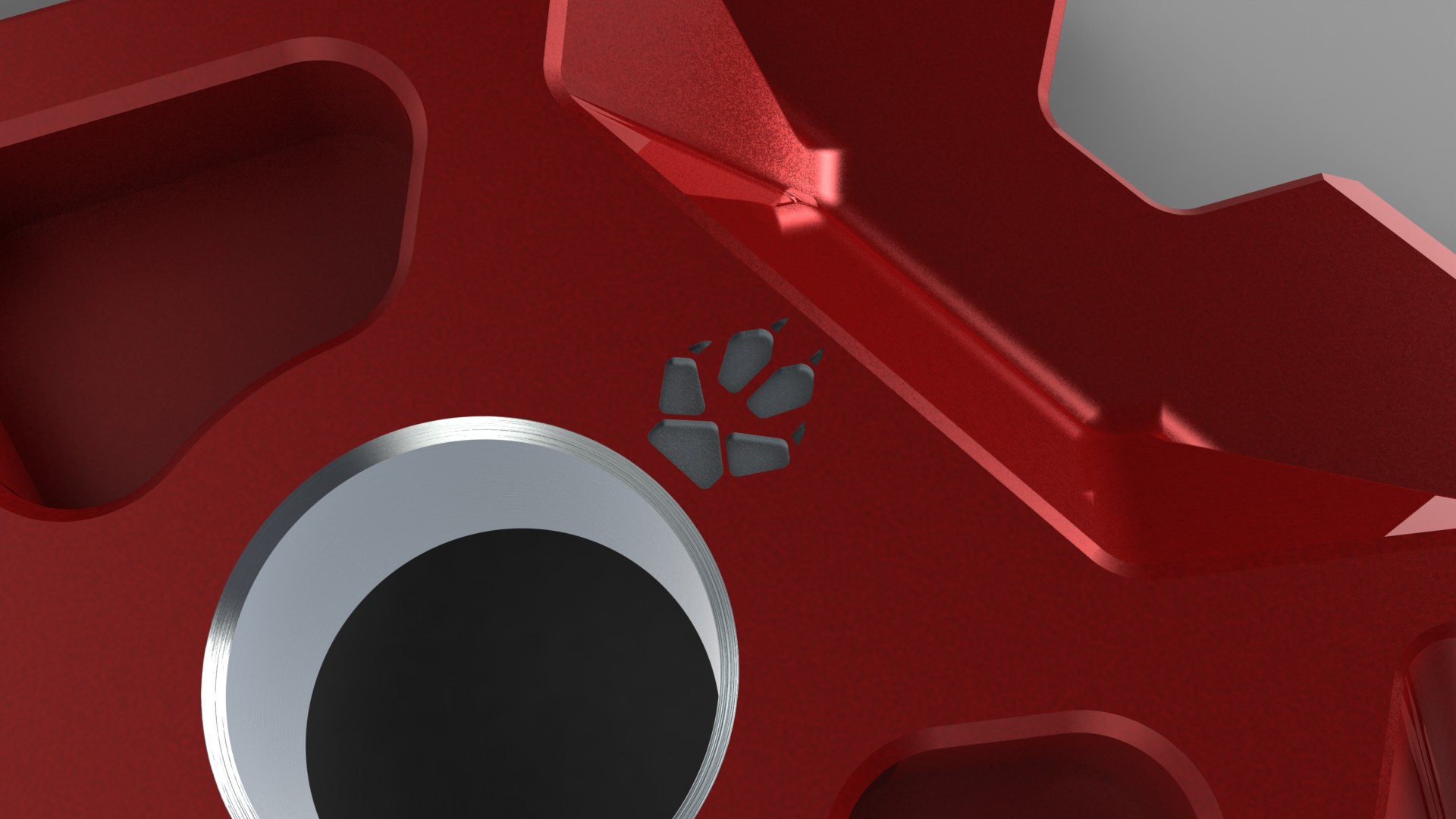

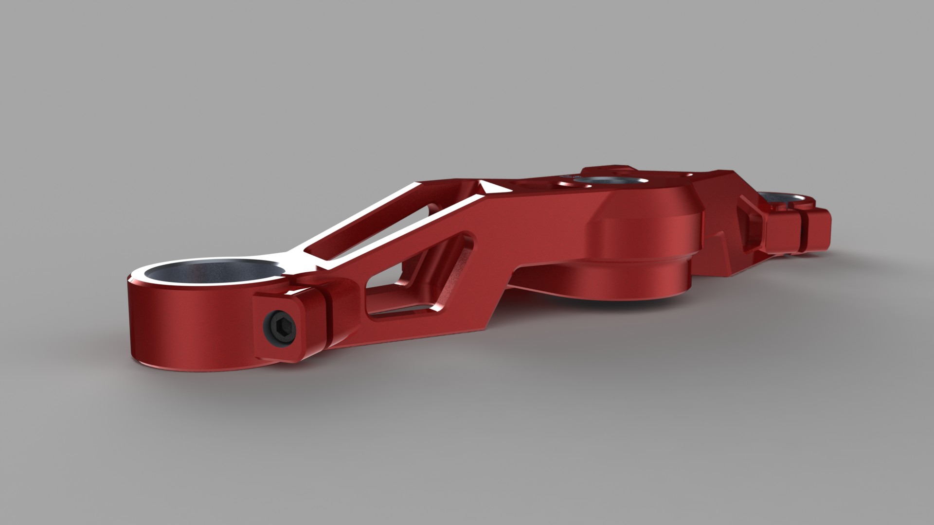

Feed Amarok triple clamp #1 By Scott Bruins on 19 Jan 16:51
(no logo yet). Just playing around with design ideas.
Weight: 2.12 lbs (960 grams)
5/19/11 Update- More weight reduction, Revised design to meet updated requirements.

    • Terry Stonehocker
      Terry Stonehocker
      I like it Scott, looks good.
      about 1 year ago
    • Scott Bruins
      Scott Bruins
      Thanks Terry, that means a lot coming from the master bike builder :)
      about 1 year ago
    • Siim Teller
      Siim Teller
      Scott, why all the complications? Is it for aesthetics sake or something else going on here?
      about 1 year ago
    • Terry Stonehocker
      Terry Stonehocker
      Actually Siim, it is not that complicated that part can be fabed with a CNC mill easy.
      The only thing I would change is I would use a larger fillet in the corners and around the front boss, so a larger end-mill can be used to machine it. That would also make the part stronger (not that it needs to be stronger).
      about 1 year ago
    • Scott Bruins
      Scott Bruins
      Its mainly just for weight reduction and aesthetics. Like Terry pointed out, unlike a traditional bike the outer tubes are pretty much just for holding the handlebars so it doesn't need to take the kind of forces a normal triple clamp would.

    • Indrek Narusk
      Indrek Narusk
      Come on Scott, make it under 1000g. You can do it!!!
      about 1 year ago
    • Scott Bruins
      Scott Bruins
      Now under 1000g :)
