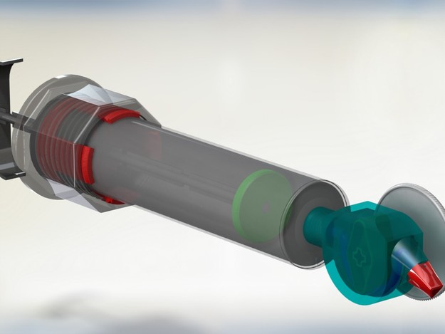

If this is a new concept in adhesive applicators. With its extremely essentialist design, this product seeks to solve old problems of conventional applicators, but using simple mechanics systems, efficient and economically viable, because the product itself does not come from any electricity or other equipment will be connected. Their maintenance is simple and its components are easily accessible. This new approach involves a new system of pressure on the back of the applicator, a peristaltic pump will trelada an atomizer that works in every possible angle.
Subsequent pressing system: has the function of pushing the piston of generating the internal pressure required for the material to flow into the nozzle. Once the peristaltic pump tube to be filled in the proper functioning of the peristaltic pump would promote this function. Thus, after the pressing is necessary only at the beginning of each operation.
The rear assembly is fixed in the tube by fins compressive effect on the threaded rear body of the tube, assisted by the cylindrical main body positioned inside the tube to back, so when the ring is threaded on the flaps, they tend to move to the center of the tube compressing the cylindrical body of the stopper against the central tube. Thus - the rear assembly is fixed in the tube by compressive effect.
Peristaltic Pump: Works from the time the user pushes the applicator, creating a rotational force by activating the presser that makes silicon passing flexible tube through the ø6mm and so by contacting the surface to apply the silicone. Each time through the full presser is released about 1200mm x Ø6mm linear adhesive without interruption, and then the material Ø decreases and returns to its default shekel, is NO FAILURES TO APPLY THE SILICON.
Rotation Nozzle: Generated Plastic (ABS) it contains a ''system click'' Fixing avoiding screws, special locks, collage materials and consequently bringing a clean and modern design.
Material: High Performance Plastics and conventional (ABS, PP, PEAD) and galvanized steel.
Mass = 324.63 grams.
