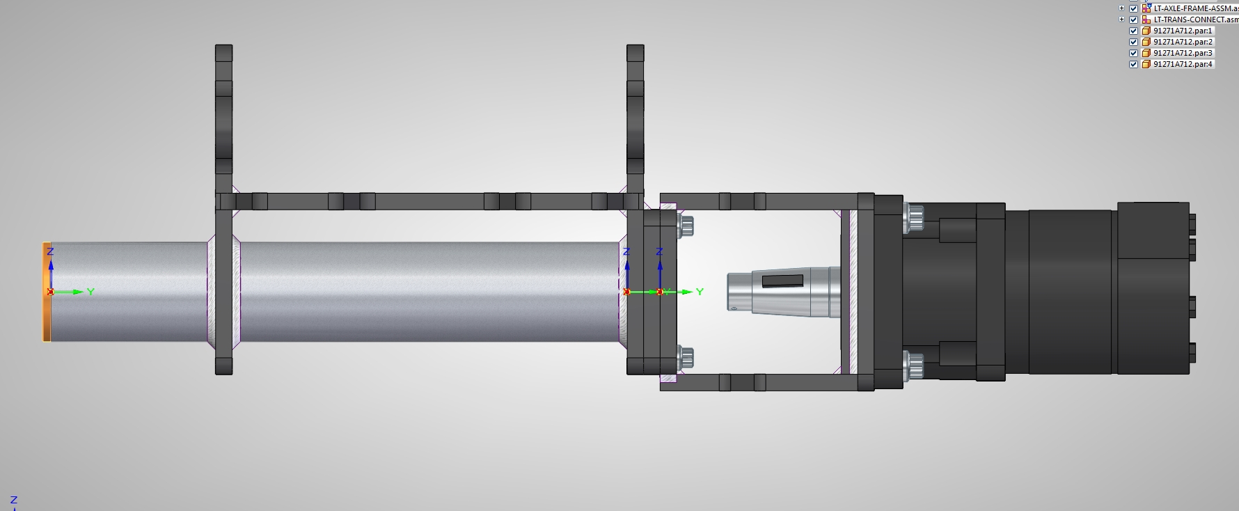

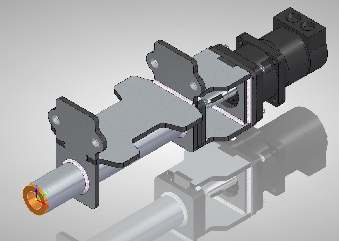

Feed Axle assembly weldment By Eric Kauffman on 22 Dec 04:13
LifeTracIV axle re-design using plain bearing and tab and slot weldment with standard 1/2" plate steel. Still working out coupling problem...
