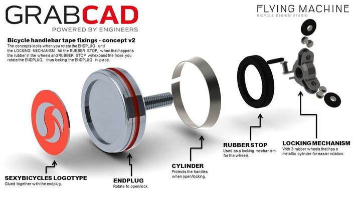

This concept uses rubber wheels in the locking mechanism to hinder the endplug to fall of the handlebar.
The locking dosnt require any tools, just twist the endplug until its stuck.
