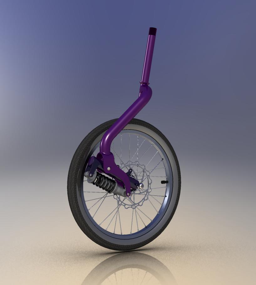

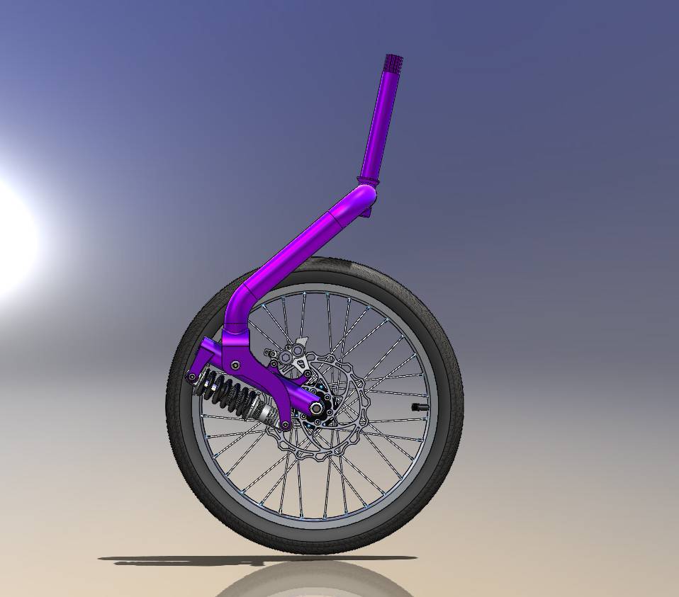

An assembly with sub-assemblies. Includes everything as on images. Included a complete assembly file of improved DNM DV-22 150mm shock absorber, a complete 18" front wheel with a disc Disc brake rotor from Indrek Narusk (thanks!) and all the details. If someone would care to make a nice rendering or animation, that would be great :)
I'm not sure how much of the functionality is kept in the STEP file.

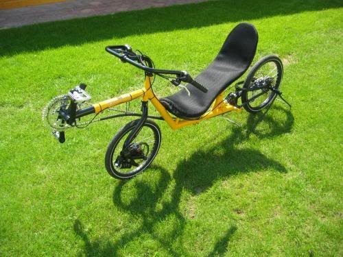

It was primarily designed as a front suspension fork for a lowrider recumbent bike, but it can also be used with a small folding bicycle or a delta configuration trike. The fork is used on Steintrikes "Speedster FS" bike. A photo of the actual bike is also included.

      Well, I could bother with that, but I'm too busy working on new stuff. This is just an example how some things can be improved without high-tech, just a properly implemented idea :)

      Did this ever go further than a model? I'm just curious if there was ever any anti-dive built in to the concept. Neat idea though.

      Aaron, the third image shows the fork on the bike. Steintrikes Speedster (google it)

      Neat-O-Matic Robert! Did you design that? Are you familiar with the old BMW motorcycles, which used "Leading-Link" front suspension? Kind of similar in concept, but the fork was swept back, and the the swingarm stuck forward from it. The shock/spring went straight up, between the swingarm and the aft-bend in the fork. When you hit the brakes, the front end actually rises up slightly; a different sort of feel...

      @Mark, this method is more like the front suspension used on Piaggio Vespa... The mother of all scooter bikes :)

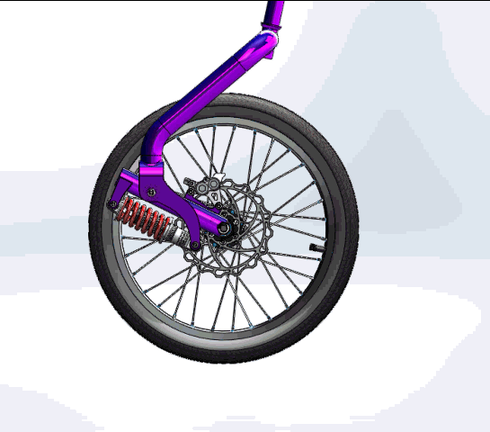

      Gif

      Nice. The suspension actually never gets that much compression, but still a nice animated gif ;)

      Thank you friends. Robert! I took the suspension to extremes to highlight the movements. =)

      OK Robert I really enjoyed your drawing. This all parameters. I improved my knowledge by studying its construction. \ o / I wanted to ask a question. The brake system is in place? I think the record should be higher? Or the "pinch" should come down? In my animation it is moved down. Have you noticed? I do not understand Nesher sorry, I am Brazilian and my English is GOOGLE.HEHEHE
