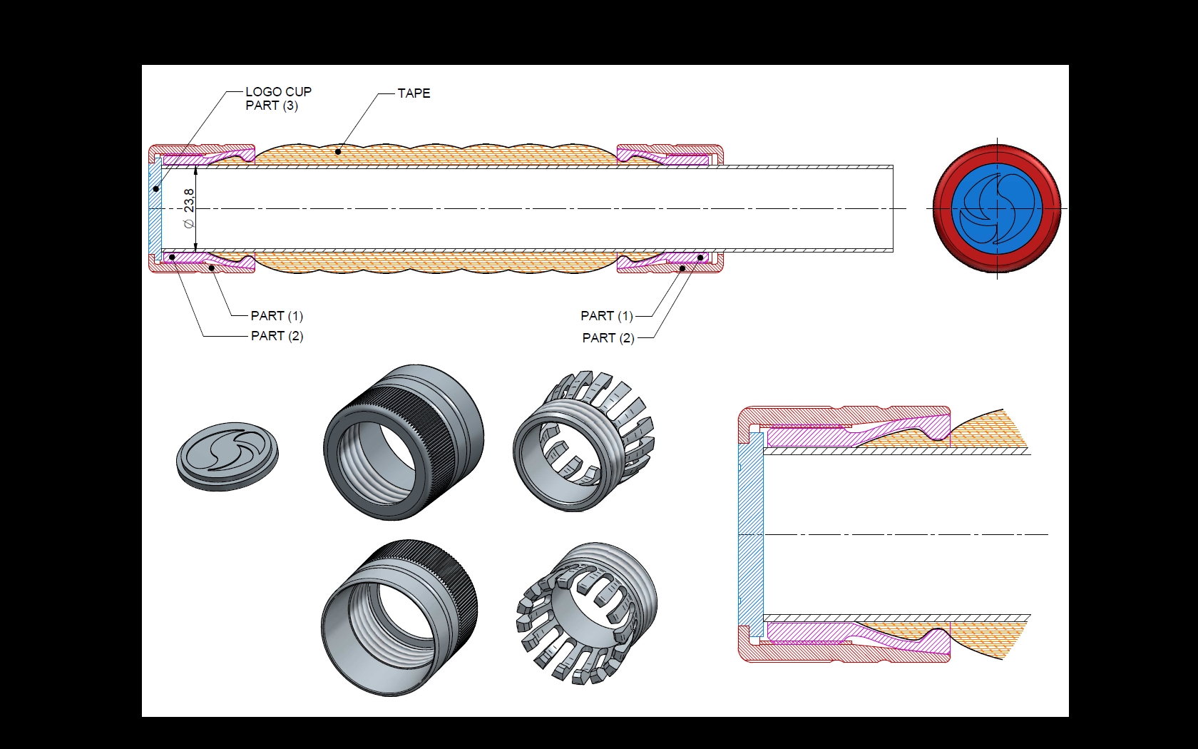

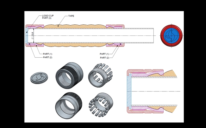

Another solution...
Idea a little bit similar to first one ( Bike handlebar special collet v1 ) but maybe better...
I will write about it later - but I think everyone understand this solutions.
The ble cup will be with logo.
This solutions alows to use this special collet on both sides of the handlebar.
On one side you need to use this special collet with logo cup (blue one) and on the other side you use only special collet (gray+black) without logo.
In this solution you need to produce only 3 parts which are universal for both sides of handlebar tape.

      Whats the length of the cap??
      4 months ago
    • Hevi
      Hevi
      Why? You want to make one on your lathe? :) For now it's just concept as you can see. You need to make prototype and then you can improve it. Regarding your question: You mean whole length?
      4 months ago
    • Andreas Gkertsos
      Andreas Gkertsos
      No buddy, i'm thinkin of participating in the challenge and didn't know what length should i design the cap. (I mean only the cap... not the handlebar)
      4 months ago
    • Hevi
      Hevi
      It's on you what you will do. I don't think that theres is some length restriction.
