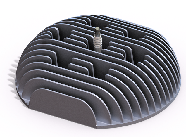

This is a cylinder head for a 1975 Bultaco 250cc Pursang motorcycle. This is the start of my project to model the entire motocross bike. The Bultaco Pursang was my favor motorcycle to ride & race.
  • Ken Schulze
    Ken Schulze over 1 year ago
    Rich - In my search for information for the Bulltaco, I discovered that there are 4 long studs and 2 short ones for a total of 6 head nuts. If the model you have is incorrect, I can upload the correct version.
  • RICH GILLEN
    RICH GILLEN over 1 year ago
    That's why I was asking, I look at the photo you have posted, and it has 6 head bolt holes on top, and when I open your STEP file I see 6 holes on top, but when I rotate it to look at the bottom, I see 8 holes. That's what has me confused.
