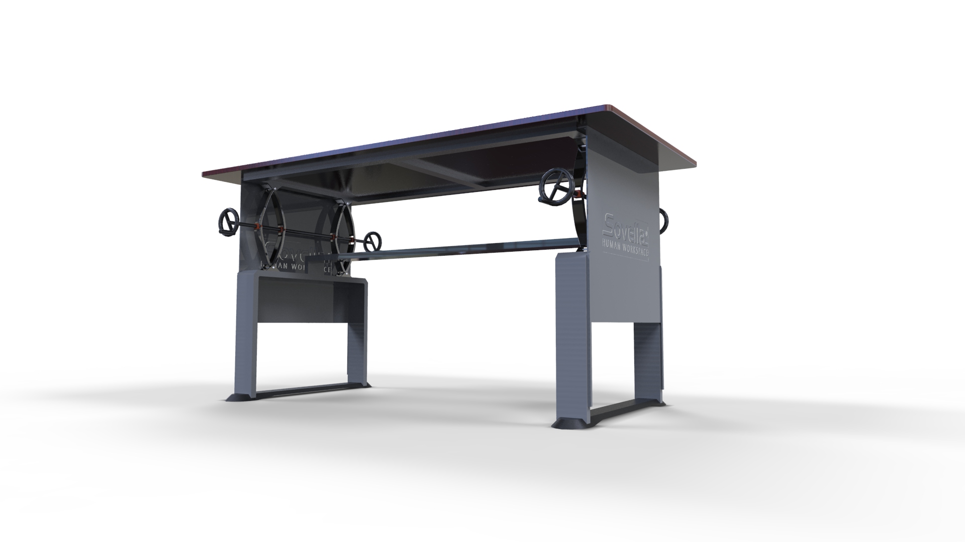

I have used two car-jack like principles per side. You first have to adjust one side then the other. In the middle of the table there will be a level indicator. Off course the two wheels also can be combined to one wheel in the middle.

      Ok, I now had some time, I am not sure if I will have the time to completely finish it. But I would like to see how you solve the stability issue of the frame. I think the 2 beams are currently in the way when sitting. For the rest I do not think the 500kg is an issue, because normally one piece is lifting a car, so maybe the lifters can be downgraded.

      No I mean the 2 long profiles which now connect the 2 frames at the side. I think they can not be there. I will add 1 instead of 2 and see how it looks like.

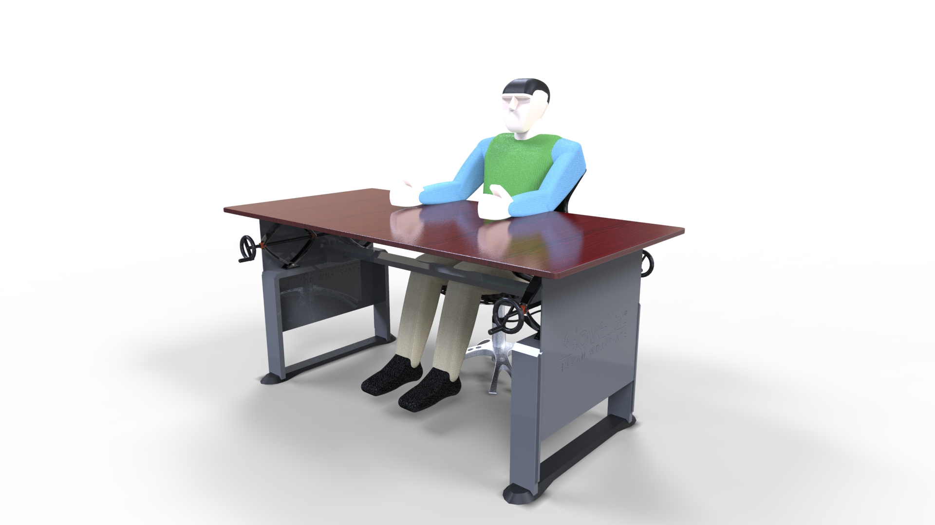

      This is what I meant, see rendering. Now one profile in the middle and also a lot higher, so more space for your knees. I will add the sitting person also.

      Its an intresting concept. Might be a little unstable, and the bar in the middle might be a problem when using the table.
      But i think those things can be fixed.

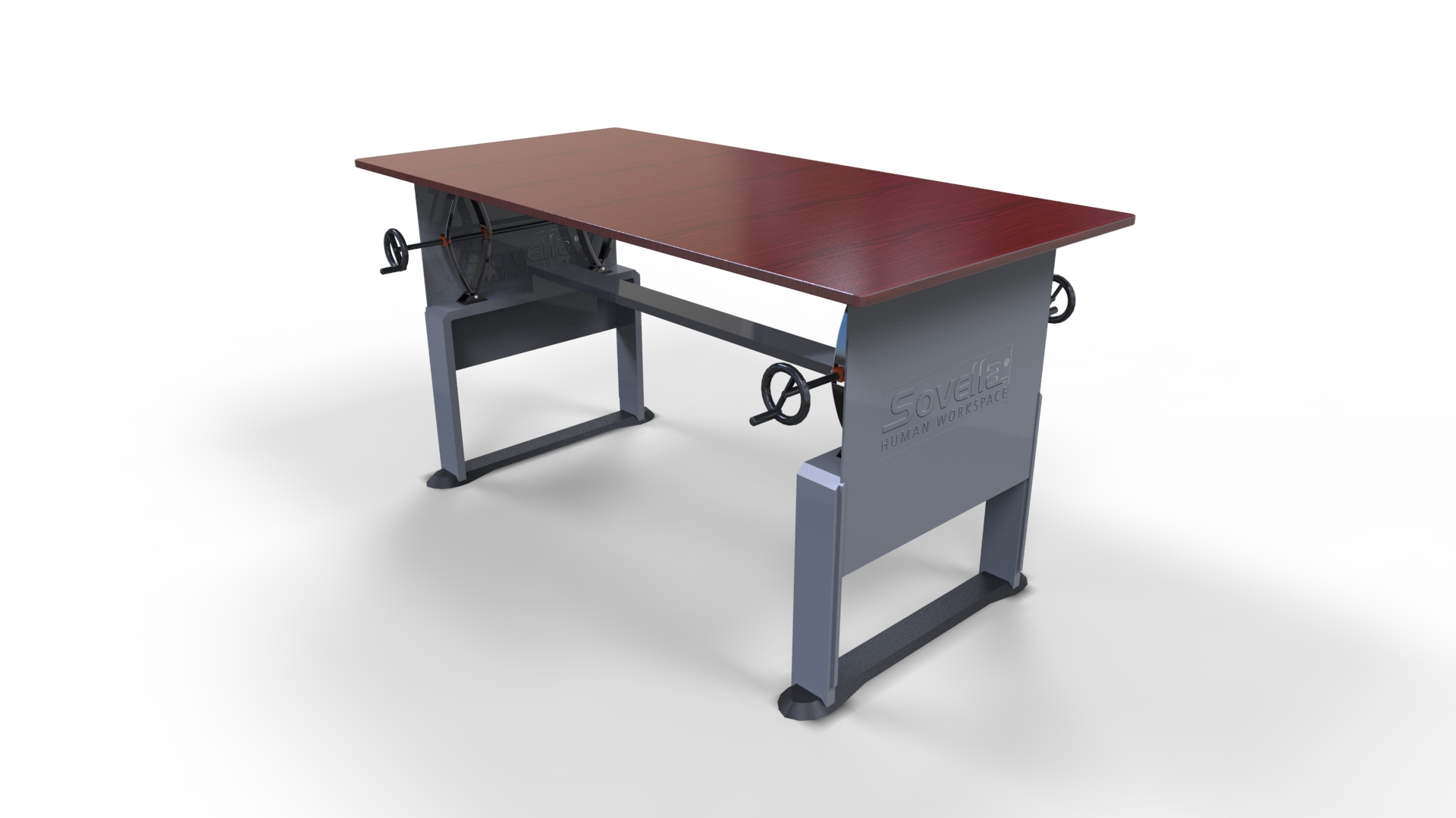

      Tobias, thanks for the comments, I have updated the design.

      That was much better. Nice with the Sovella logo on the side there also.

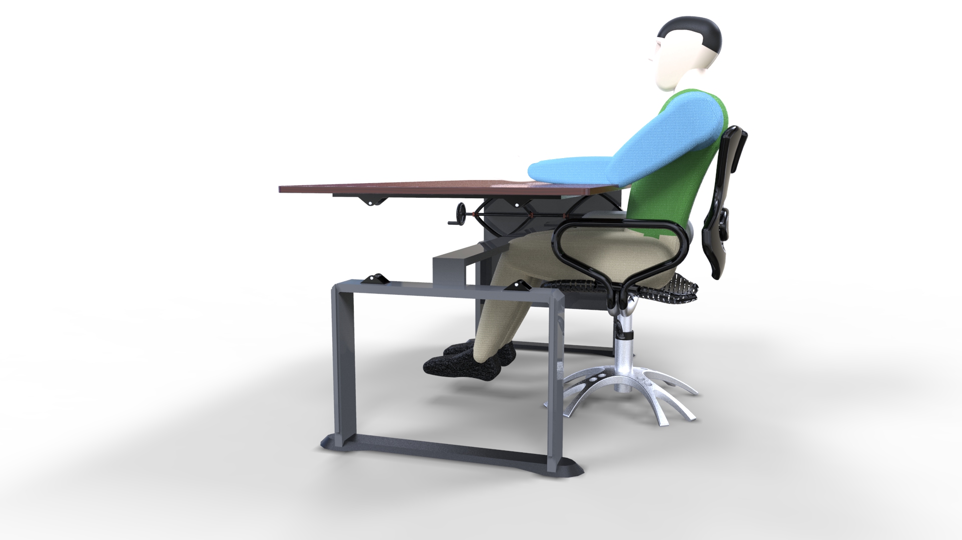

      Beam in the middle is in the way for the knees. So I have to get rid of it. I will move it backwards which is a pity because when it could be in the middle it did not matter how you would place the table, both ends were the same.
