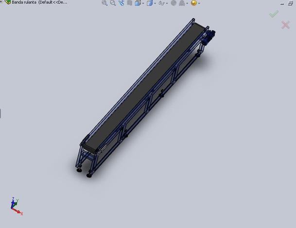

Johnny - It looks like you are doing a screen capture of your SolidWorks screen. To use PhotoView 360 do the following;
1 - from the Tools menu click on Add-Ins
2 - check the PhotoView 360 check box from this menu
3 - a new PhotoView 360 option will now appear on your SolidWorks main menu
4 - now from the PhotoView 360 menu you can edit the appearance of your model, edit scenes and backgrounds, change lighting, apply decals, modify other options, preview your rendering, and do your final rendering
Johnny - the rendering was done from within SolidWorks using PhotoView 360.
yes i know but i don't know how.
My rendering are way ,way worse than yours
