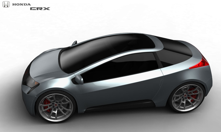

This is a quick writeup i did to show how to convert Quad based polygonal models to NURBS surfaces. I used a project I did from school. I’ve provided the original Low Res .OBJ file and the final .IGES file of the body for reference. I’ve also uploaded a PDF with one long page with the writeup.. Enjoy.
