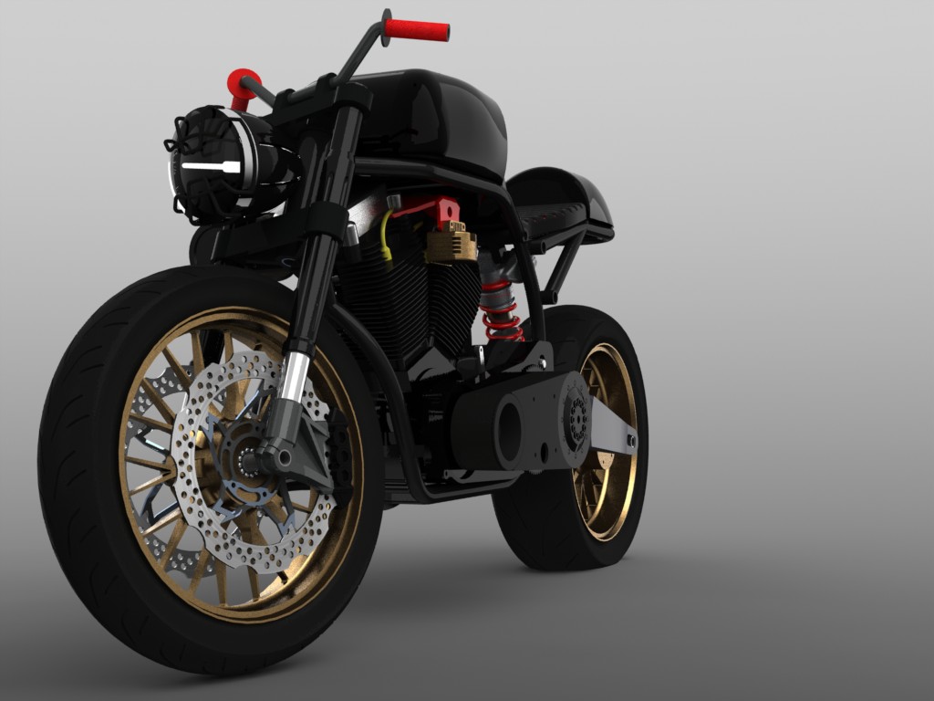

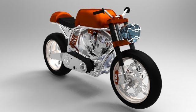

This model was inspired by a bike that I have wanted to build for the past year or so. Using Terry's motor for the heart, I pieced together a standard/naked bike that draws a lot from sportbikes. The idea is for some old school American muscle with the latest-and-greatest updates. I really tried to replicate the look of the PVM Buell X1--which I included a picture of in the Zip Folder--without totally copying it altogether.

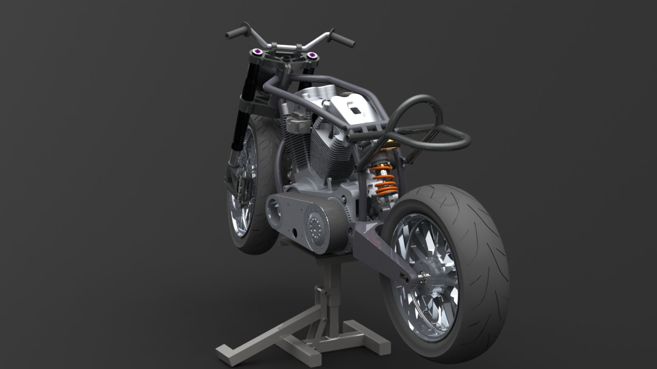

Starting with the most 'patriotic' engine, the 1000+ cc V-twin, I chose a compact frame with a steep rake for adept steering. I only provided three mounting points for the motor to make it easier to install, but a top cross beam and mount would be easy to add.
The front end is something straight off of a supersport to make sure the bike is agile. Forks are upside down USD and radial brakes with 6 piston calipers, the largest available. Front rotors are drilled till they resemble swiss cheese, giving it a classic speedmetal vibe. Both wheels are a forged design to lower weight, but 10 spokes resemble spoked wheels so they don't look too showy.
Rear shock has been optimized by going with a single shock design and setting it at an angle to eliminate the need for a rocker and increase responsiveness/reduce part count.

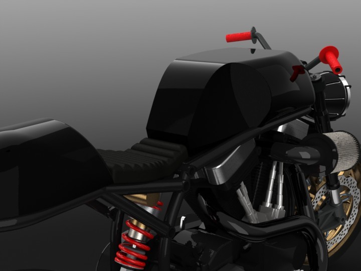

      Chanson, great work, as always. Especially like the pipes and golden engine in the other version you uploaded. I'm not sold on the seat, though. It reminds me of a sponge or something, and the "sharp" edge on the side cannot be too comfy. I'd keep the line of the seat straight to fit the overall simple and clear lines of the bike.
      But that's nitpicking, as I said - excellent work. Now, want us to figure out a way to upload all the parts separately into the library without much manual work? :)

      Thanks Siim, you are dead on about the seat, I was attempting to curve the edges, but it is quite a hard operation and I have to design it up from scratch again. About it being a sponge though, that is funny. I guess I was copying a friend, he made a seat for his bike, you can see some photos here:
      http://d.pr/F1aI
      http://d.pr/DKSV
      ……we called it “marshmallow” XD
      A way to automatically load each file into the library from an assembly?! Ingenious idea.

      Siim, how do you like the new seat?
      http://d.pr/WtXC
      http://d.pr/CbqF
      Thanks Scott, my thoughts exactly. All muscle, no superfluous bodywork or accessories. Who needs turn signals?

      Much better. Liked the white version you linked to, too. But I should't really comment on real motorcycles, I'm a Vespa rider myself :)

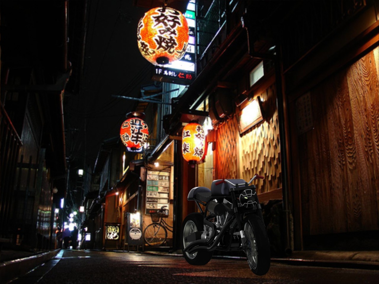

      Rockprincess, nice work though small problem - the front tire is just a bit floating in the air…
      11 months ago
    • rockprincess
      rockprincess
      thanks siim. i will fix the problem.

      Nice! The colors look pretty real good.
      Siim, the bike is about to pop a wheelie ;).

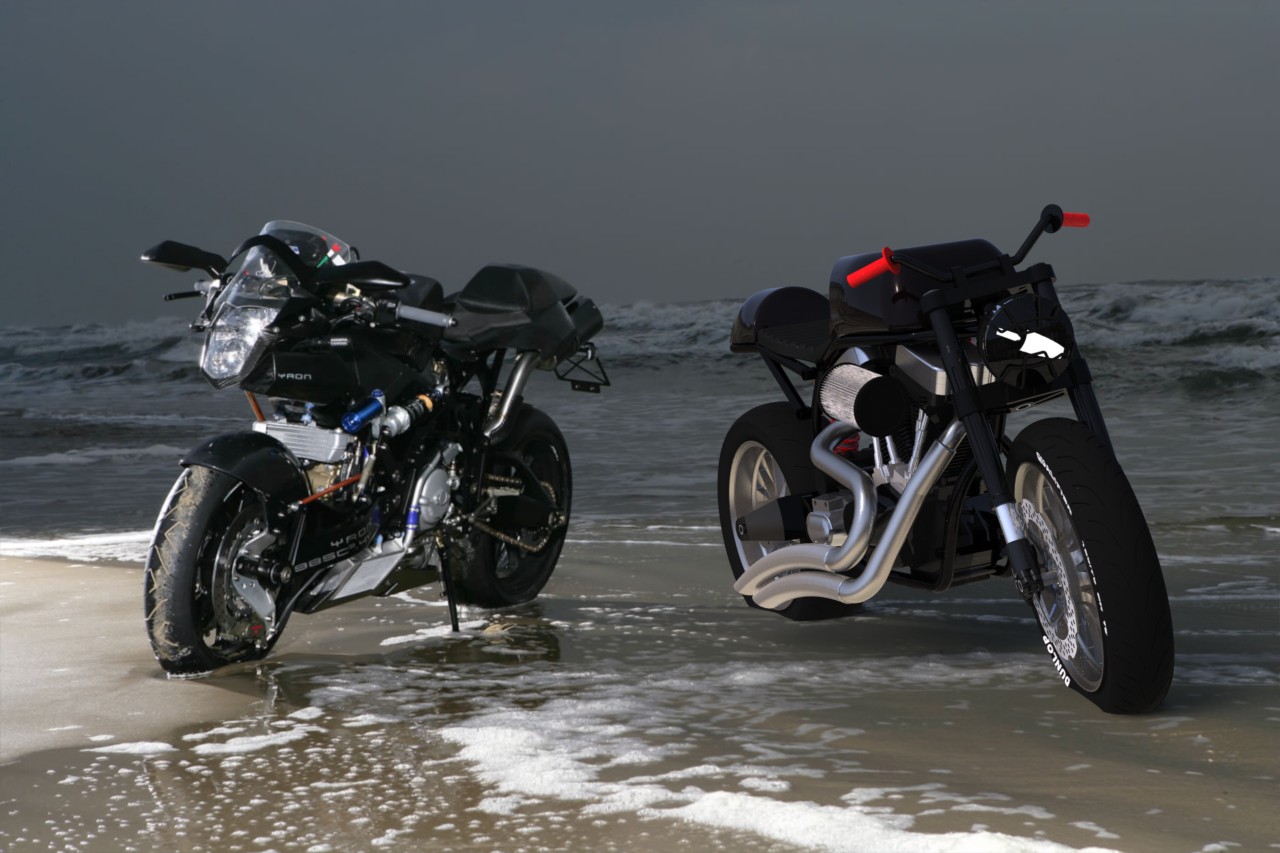

      Great muscle look. I noticed you did a rendering with the vyrus...I want to do a bike with that front suspension...do you know anyone who has modelled that? thx
