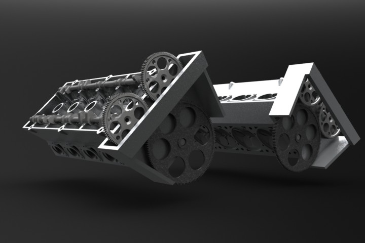

Feed Cylinder head assembly By Chanson on 14 Dec 06:14
Pair of Cylinder Heads, complete with camshafts, inlet/exhaust valves, sparkplugs, and gear drive.
I modelled the valves in pairs to ease size/part count and hopefully streamline movements. Less parts and less mates.
The cam gears are intended as injected plastic with carbon whiskers. Should provide a better interface than metal on metal.
Enjoy.

      Sorry about the file size.

      File and model size is impressive Chanson.

      Really great! Good testbed for me to learn about engine.

      U done it again Chanson, impressive and inspiring.. thanks very much for sharing. i'm glad i found this.

      good job mate. but if you decide working on this project and make this into a complete engine, don't forget to utilize that idler gear as balancer. that'll save you some flywheel mass.
