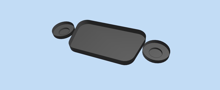

This is an iFeature for D-sub 9 and D-sub 25 punch.
Hex nut jack screw spacing - 25 mm.
Procedure:
- select the plane;
- input the rotation angel;
- input the panel (sheet metal) thickness;
It lefts a 0,5mm thickness panel for milled holes for jack screw.
Usually I'm using it with 1-2 mm thickness panels.
