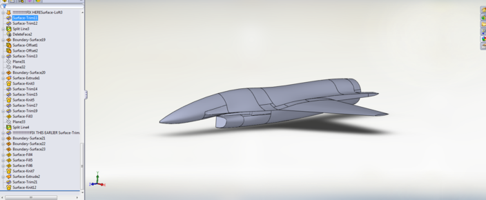

I completed and knitted all the surfaces together, however they refuse to form a solid. Does anyone know any tricks to do this?
Please download the file and see "Surface-Knit12" (final step). Whenever I try to make a solid, it says I have 'intersecting geometry" or sometimes it gives no error at all.

    hi Min,
    There has to be a gap between surfaces or a self intersecting area. Otherwise your madel has to become a solid in one click.
    Better to check it in detail.
