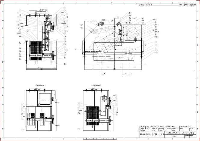

Fire hose brusher
This fire hose brushing and washing device allows coupling all dirty hoses together and pulling them through the rotating brushes. In order to remove all dirt from hoses, spraying nozzles are installed between the brushes. When the coupling attaches the rotating brushes, the torque load of e-drive increases and the upper brush lever opens the gape automatically by actuating a pneumatic cylinder. The gape time is adjustable and allows pulling through the coupling.
