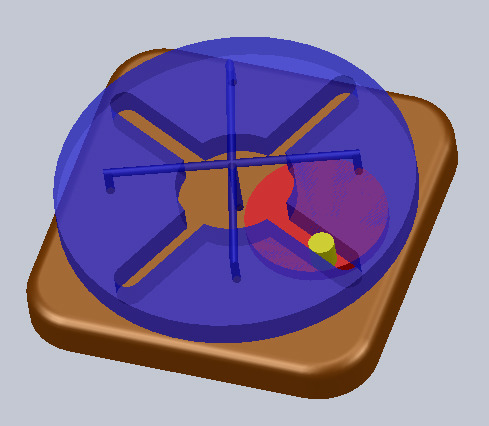

Hi everyone, I need help to move my geneva wheel. ¿somebody knows the relations in Solidwork to do that? thanks.
Click on NEW MOTION STUDY than CONTACT ( click on both wheels ) than MOTOR ( click on small wheel ) Than CALCULATE and PLAY DONE......
PS : you can see the difference in design of your Geneva wheel be me video and that one from your video
You can not do it in modeling tab. As Marcus says, it is only possible in motion study.
(i'm %90 sure)
DONE......
