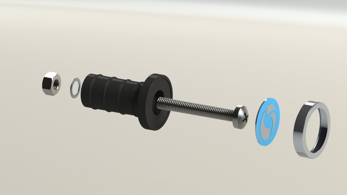

This model is made for the challenge of the bicycle handlebar.
I focused most on how to make it as simple as possible. My idea is to use a mount.. this is made of rubber. On the one side a screw goes through all and in the end a nut bolts on. On the mount there is a special cut so that the nut fixes in it and as we screw it on, the nut presses the mount back, compressing it, and causing it to expand in diameter (as its length reduces). Than we puto the logo bar on top of the screw and wear the cap on it.

    the alternative would be to make a thicker plate in the bottom with the tread in it so you do not need the nut.

    Yes but i thought of making it as simple as possible... but yeah i'll try that.. Thanks:)

    I also have made a Hex flange nut that could be used maybe, it gives alittle more space.
