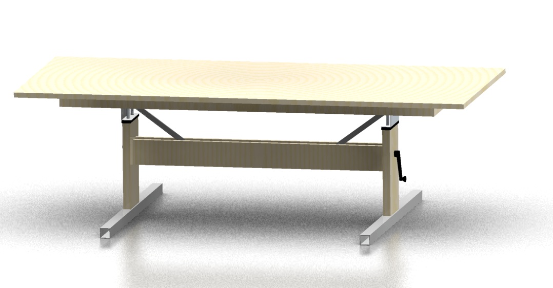

Feed Height adjusting table concept By frei on 18 Dec 15:43
The design based on of screw gear. Just concept.

      Does this design give you 400mm movement?
      I tried something similar, a one sided scissor jack and could not get it to move 400mm.

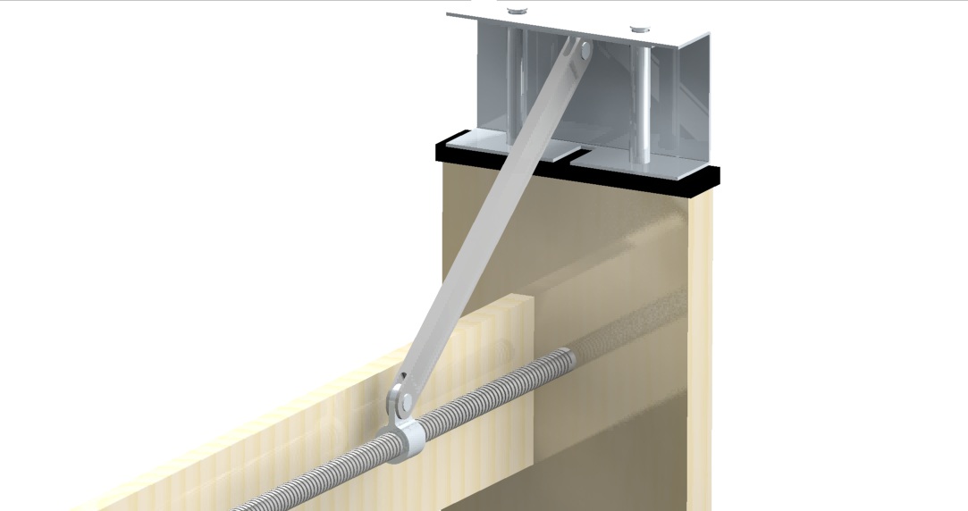

      I have a question. When you turn the crank in clock wise direction, one of the nuts on the lead screw moves to right side, in order to move table top upward. What about second nut? It must move in same direction as first nut. How the second nut will move the table top upward? Thanks, in advance.

      it is a 2 part screw, one half is right hand thread, the other half is left hand thread

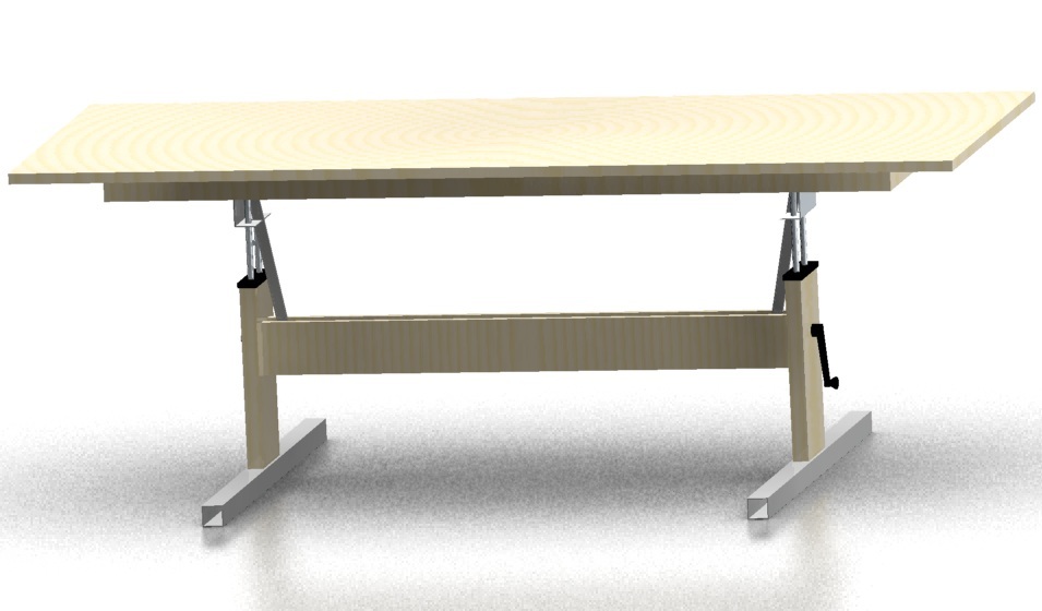

      Сoncept will require design improvements to ensure 400 mm movement. I have some idea.

      improved in height adjusting table
