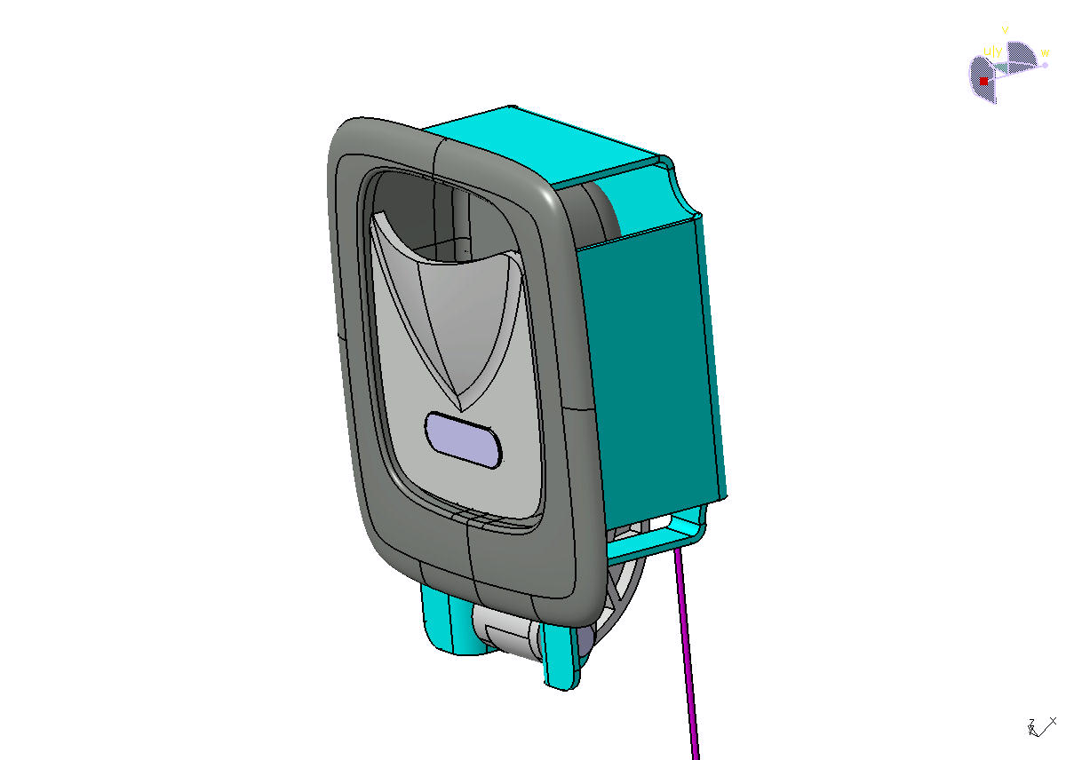

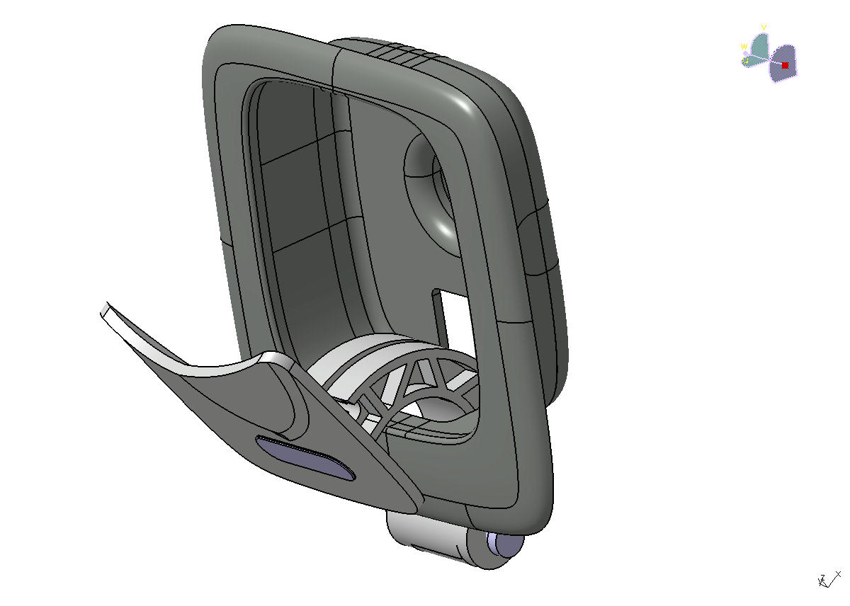

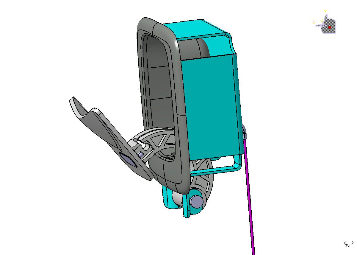

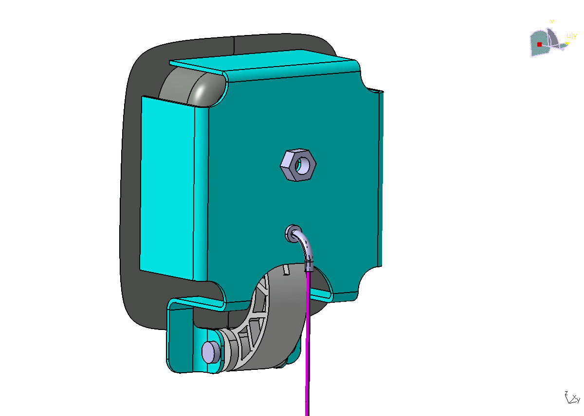

Same basic concept as the round handle I submitted, however in a package that drops into existing rocker hole.
Carbon fiber pull cup held in place by a stamped stainless steel backing plate. Lever is machined aluminum, as well as pull handle. Pull handle is fastened after pull cup is installed, as screws are covered with a Plaque bearing the Koenigsegg name. Return spring at pivot pin.
