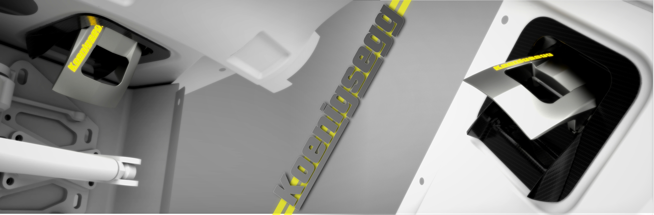

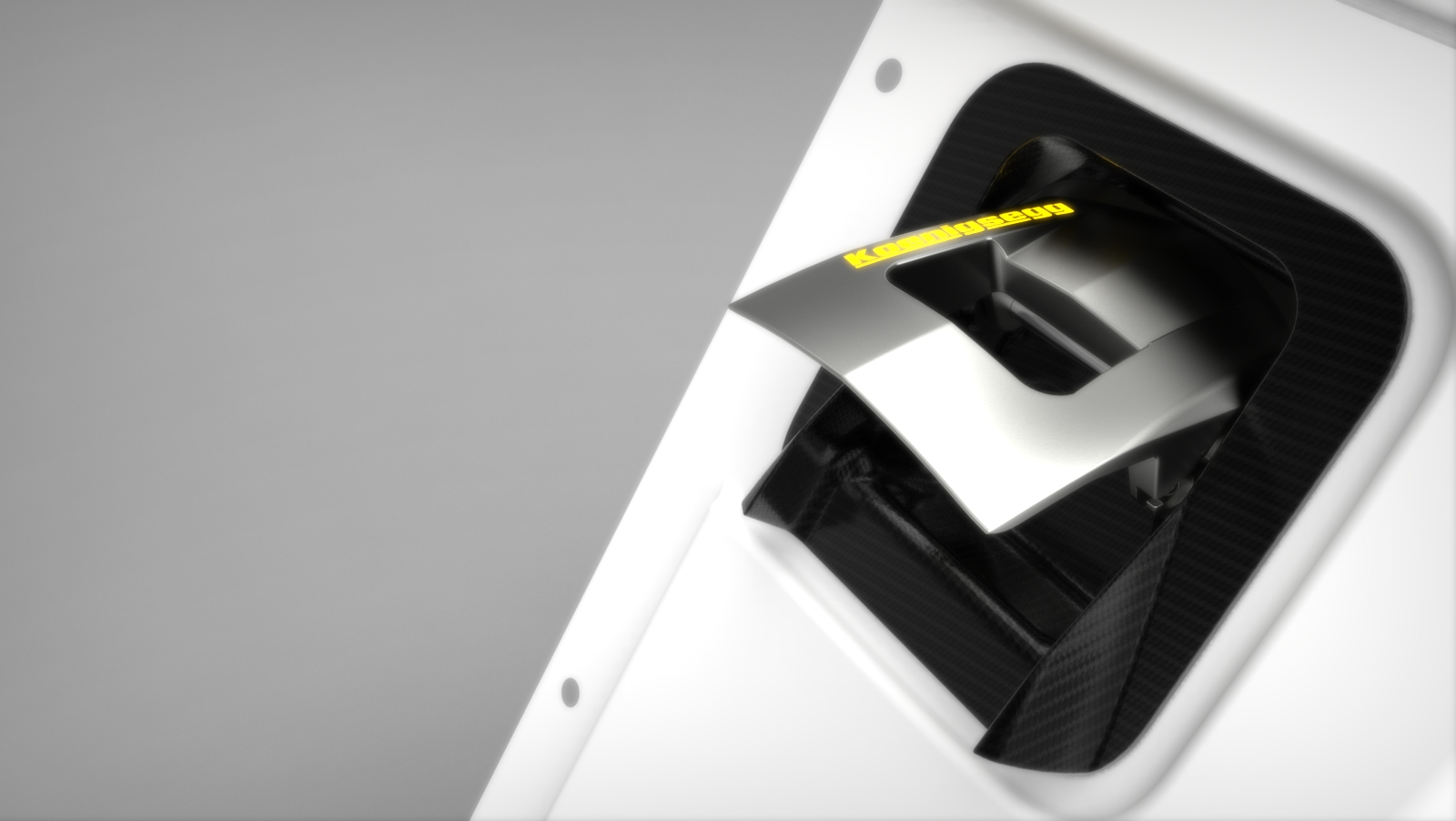

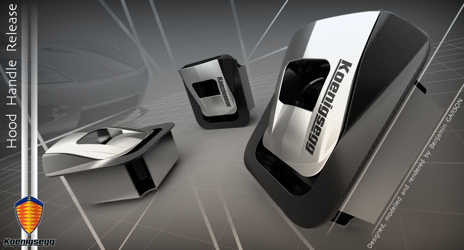

Here is my concept for the Koenigsegg handle.
We’ve got a mixed material, with carbon fiber for the case (it’s almost like the original one) and aluminium handle (3mm thickness).

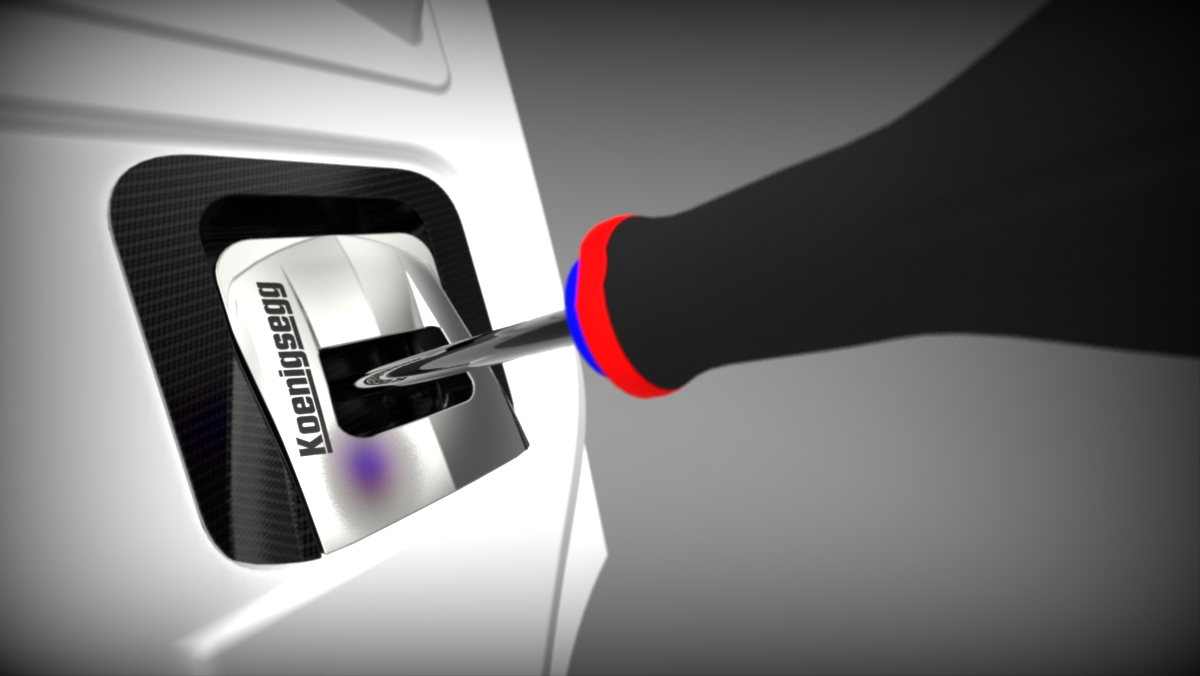

The main goal was to remind the sport hood look with agressive lines, an air intake look which enhance the ergonomy and make an easy access to fixing screw.
I hope you’ll like it and don’t hesitate to leave a comment !

    • Matt Perez
      Matt Perez

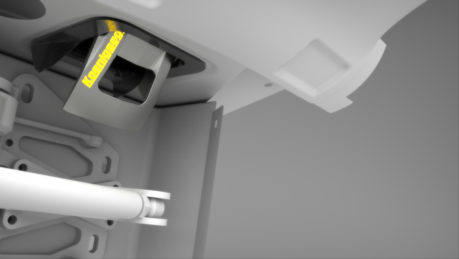

      very nice design ben! my only comment to you is about the travel. Your cable attachment point is just under 19mm away from the pivot. with this distance I dont think you physically have enough travel on your handle to get the 20mm cable pull. That and as the handle rotates you are actually dragging the cable against its opening in the CF body. I think if you make the cable jacked retainer on your CF piece and maybe move the pivot point farther away for the cable you would nail it. great render too by the way.
      8 months ago
    • Benjamin Garson
      Benjamin Garson
      Hi Matt ! Thanks for your comments, I didn't check the course, so I'll.
      For the location of the opening, I'll check that too, but as there is force applied on the cable, it may have to pull the handle back to the rotation, that's why I put it on the top side.
      Anyway, thanks, I'll give a look tomorrow and make some slight changes :)

    • Benjamin Garson
      Benjamin Garson
      @Sylvain : Thanks my friend :) I really appreciate to see that you like my design and presentation. You are a reference for me ;)
      BTW, model uploaded ! Change view things to be sure that the cable will make at least 20mm course, and added a slight bossage on the pivots to ensure that the handle will stay in horizontal position when it is closed.
      Video coming soon :)
