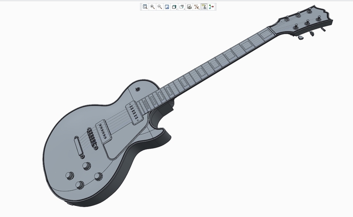

step file version of a les paul
Hi aarggh, it's preaty much accurate, except for the angle of the headstock, which is 15deg and should be 17/18deg approx (I modelled it off the original plans)
great work !
new step file in mm to correct scale (guitar-2_asm.stp)
