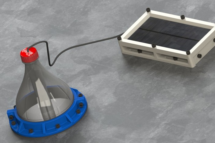

This is my design,it may be placed on corrugated roof or flat
roof ,only for corrugated roof must have attachment
(corrugated roof cartridge).
Led's , need just to be inserted
into holder,solder led's whit cable,and all that put in tube (this part looks like test tube)
tube put in bootle and screw up original cap.On cap need's just to bore hole for cable.
Bottle is attached to roof whit (bottle holder's),surrounding bottle and seal between bottle and bottle holder's and make It is watertight.Whit another seal can be put on flat roof.
Battery's are under solar panel in box.
-Tube,Led holder -must made from clear plastic to allow light to pass
-To prevent leakage some parts can sealed with silicon
-On some places number of screws can be reduced

    thanks naveen thontepu number of screws can be reduced when we put on corrugated roof ,but when is thin metal sheet for roof i think must have more screws to prevent leakage.Because whit less number of screws thin metal sheet can warp and will leak into house.But on solar panel box can reduce number of screws.

    Seems easy to make, easy to assemble, simple and true. Not clear how we will manufacture the LED filament....since we can't 3d Print in fully transparent material.
  • Nemanja Stojanovic
    Nemanja Stojanovic 8 months ago
    I did not know, that can not 3d print transparent material.But for the mass production that is
    not a problem.
