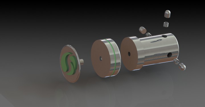

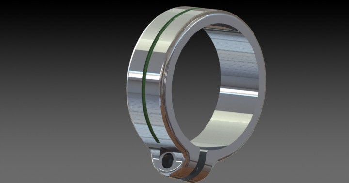

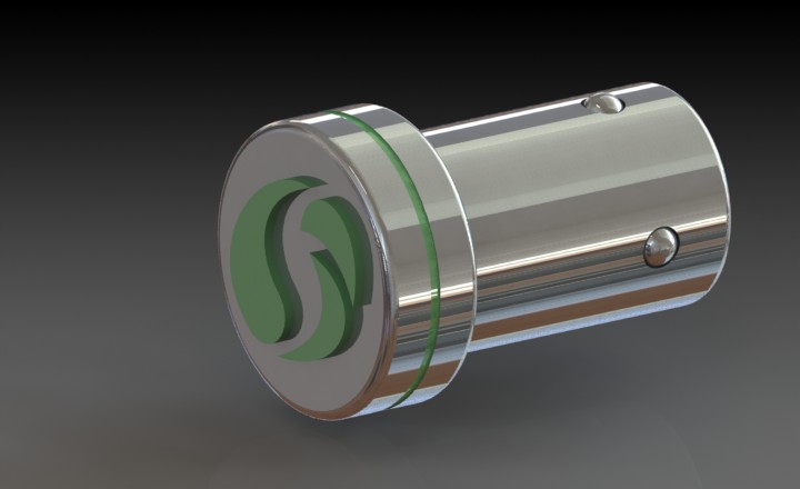

Plug is made out of several parts. There is a body that goes into the handlebar. To prevent fallout the body has 4 spheres that are connected to 4 little springs. That's why the handlebars should have 4 holes (look at the picture). The body also has a threaded hole M4 on it. The cover is a part that goes on the body and the tape should come in between those two. The cover also has a threaded hole M4. There is a part with the logo and on one side there is a logo and on the other side there is a threaded shaft that keeps everything together. The ring is almost the same as on the drawings and the ring has a single screw. Hope it works :)

      Just an ergonomic thought, can you imagine trying to press all four of those balls in at once to remove it? I would reduce the number or it'd be impossible to remove.
      4 months ago
    • Branko Stokuca
      Branko Stokuca
      You might be right. My first idea was to put just two of those but somehow I decided to go with 4.
