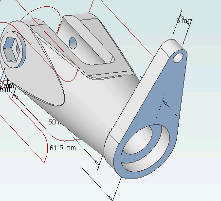

R/c helicopter blade grip
14mm blade root and 19x5 bearings , i modeled this with measurements from my trex 700 blade grip. youll need to rotate model the pitch link 180 degrees at the base or the opposite end will be upside down as noted by the nut instead of the bolt face showing on top. i made this one a bit chunkier than the trex
