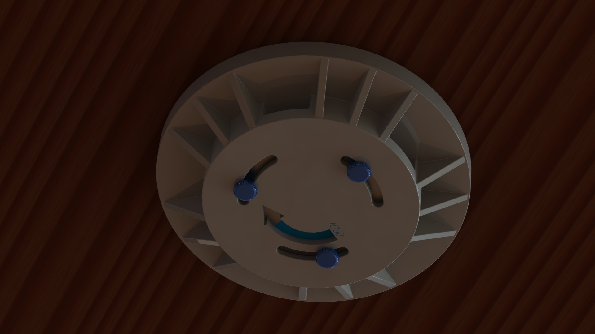

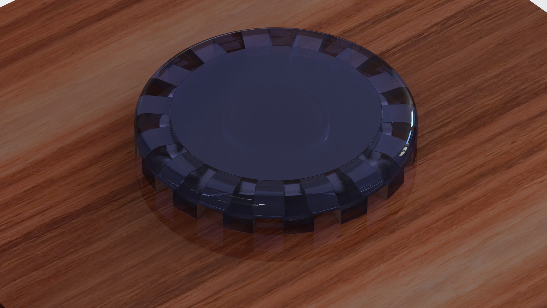

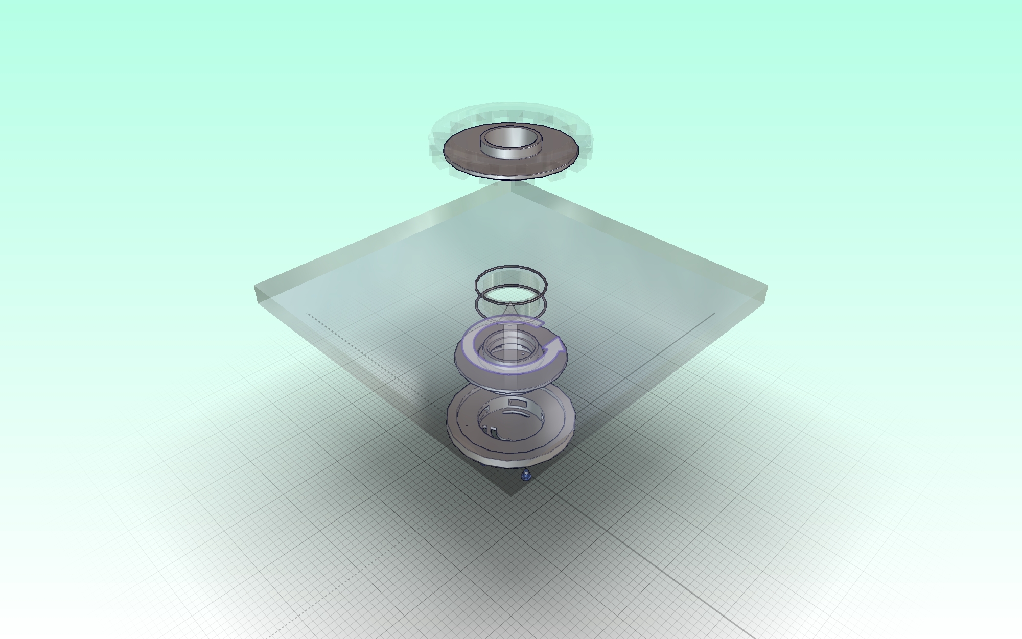

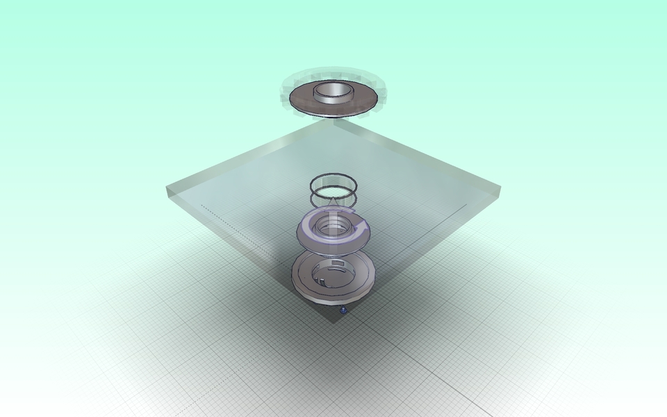

Project vent windows for the yacht.
Material used:
The top cover - tempered glass / stainless steel
the lower lid - stainless steel
inlet cover - plastic
Screws are used only for fixing the rotation of the inlet
cover
The upper and lower lids fixing with thread.
Sealing the top cover to the deck with rubber rings and
sealant

      can be made of glass to the outside, too, was clear indication of
      10 months ago
    • dassault
      dassault
      Bent, I'm sorry, but I do not understand something comment (my translator from Google's very bad)
      as I understood comment refers to a material - the glass?
      9 months ago
    • dassault
      dassault
      in the near future I will try to describe in detail this model!
      more clearly the mechanism is shown in another embodiment of the window (instead of glass there steel) - look at all my options vent windows.
