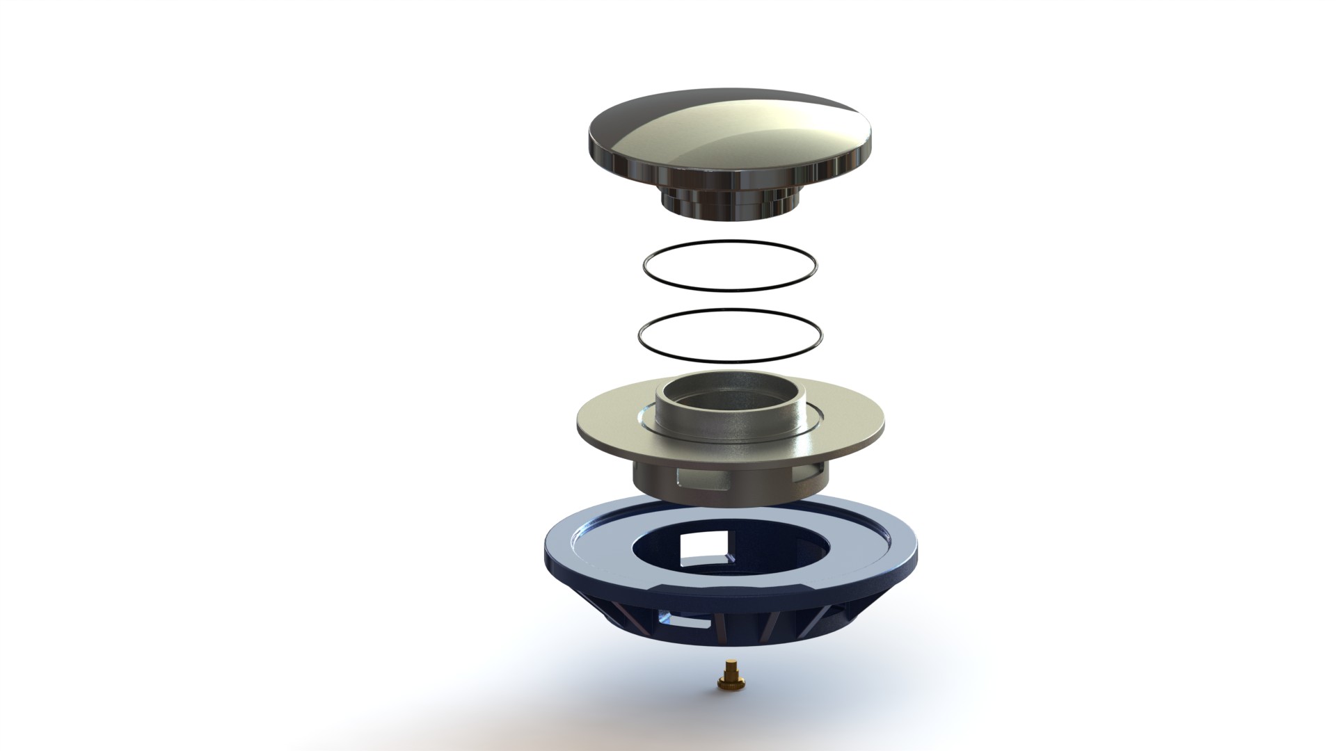

Vent windows for yachts
Material used:
The top cover - Chrome (nickel plating) steel
bottom cover - santirovanaya (oxidation) steel
cover the windows - plastic
Ventilation window is opened by turning the lid by its rotation around the screw. The screw is needed just to maintain cover and control the forces pressing.
  • Download
    Original: saareyachts_...
    1.47 MB
    August 5, 2011 by dassault

    • dassault
      dassault

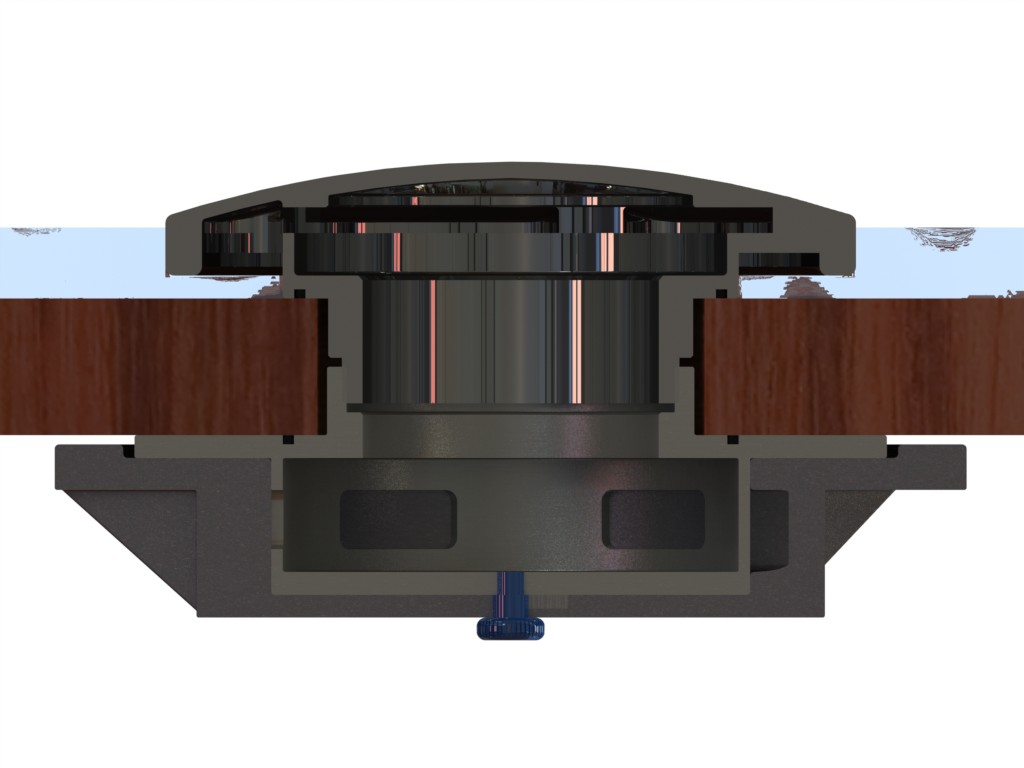

      thanks for the criticism, it is useful remark.
      hard to compete with professionals like you, but I will say in defense:
      - The border of the upper lid to be lower than the central, through this, even when the slope of the yacht with a full deck water popodat water will not be in the central part of
      - To ensure the integrity of a rapid lateral flow can be predumotret face, as one of my models from sheet metal (rubber seal)
      - Instant soul will not, if the water and hit the central part, it will meet in the middle and the bottom of the shoulder would not allow her to pour out at once when you open
      ready to listen to any criticism!
      10 months ago

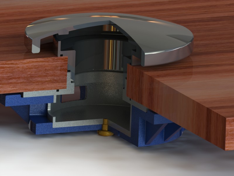

    • Danny Tasmakis
      Danny Tasmakis
      Sorry man, I sort of get what your saying but if you get water to a depth above the cap on the deck wouldn't water flow up and over the inner ring and fill the chamber?
      10 months ago
    • Danny Tasmakis
      Danny Tasmakis
      Thanks for the extra image dassault! Now I see, this is quite clever, you have to make sure that when the vent is closed it is 100% air tight and in an ideal situation it would work fine, I just don't know on a yacht that is swaying in all directions with water splashing everywhere, I really like the thinking though :)
      10 months ago
  • dassault
    dassault added a rendering 10 months ago
  • dassault
