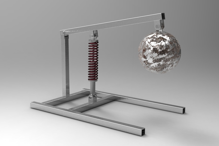

A structure I’m building to find out through experimenting the elastic constant of the Shocks I’m using to build a vehicle..
  • PabloK
    PabloK over 1 year ago
    How will you collect the dynamic data?
  • Diego Montero
    Diego Montero over 1 year ago
    I'll do an estatic experiment with the spring on so I can get the elastic constant, and then I'll do and dynamic experiment without the spring, releasing the weight so I can get the time needed for it to go from open to final course position, and use this to get the damping constant... Something like that..
  • Ramses Chavez
    Ramses Chavez about 1 year ago
    That's interesting, why don't you put a quick release fastener to take off the weight from the structure?, but carefully.
