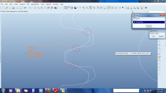

Spur gear meshing in pro/e
This is made acc. to Machine Drawing Book. But when I assemble them in Mechanism in ProE, it Show that Involute Profile is Intersacting each other. That can be See in Video and Images, The little Red Light/Line are the Intersecting Part.
So I need the Correct Practical Method to Make Involute Profile of Spur Gear.
If any one know about how to make it. Tell me.
  • mishikhan
    mishikhan 3 months ago
    you can add some "backlash" to the gear or pinion. I would suggest you some of the softwares like MITCalc, GearTrax or Gearteq, KiSSsoft etc.
