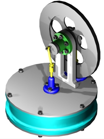

Stirling engine assembly
This is the assembly of all the Stirling Engine parts that I have uploaded recently. I have built this engine and run it both hot and cold and by this I mean I have sat it on a heat source like a lamp or I have sat it on dry ice. The direction of motion depends on weather it is hot or cold. It runs anti clockwise hot and clockwise cold.

    I am going to attemp using your files to make one myself. C could you post the materials you used and any dimension that are crucial in making it work properly?

    All the individual parts have been uploaded with material specifications. The model will run if built exactly as drawn but it is not self starting as the fly wheel needs a nudge to get going.
