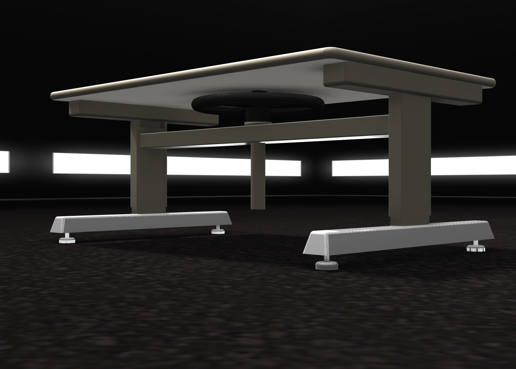

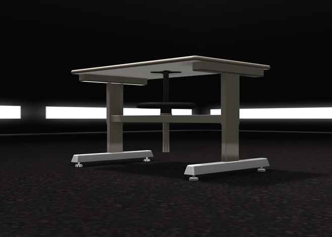

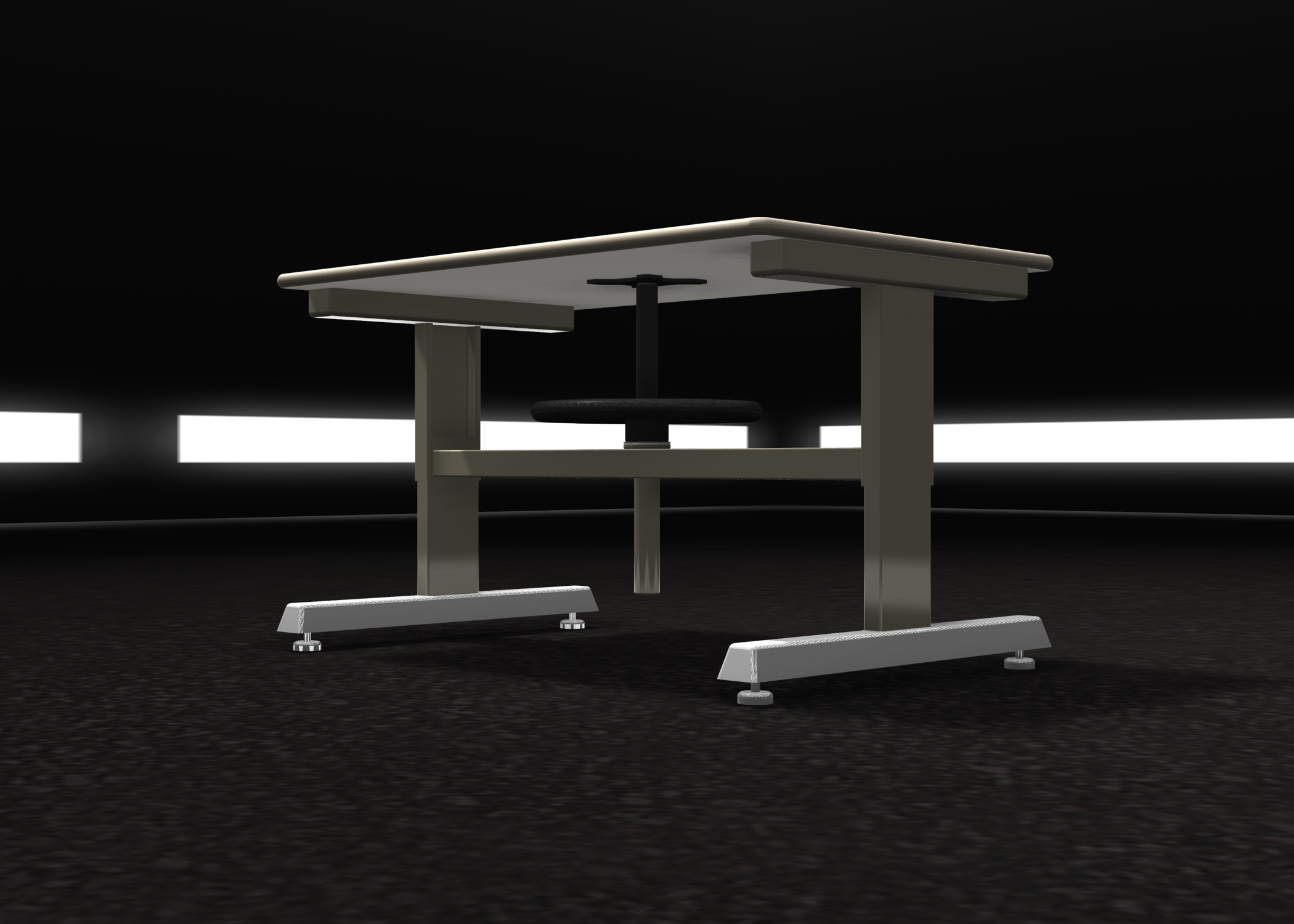

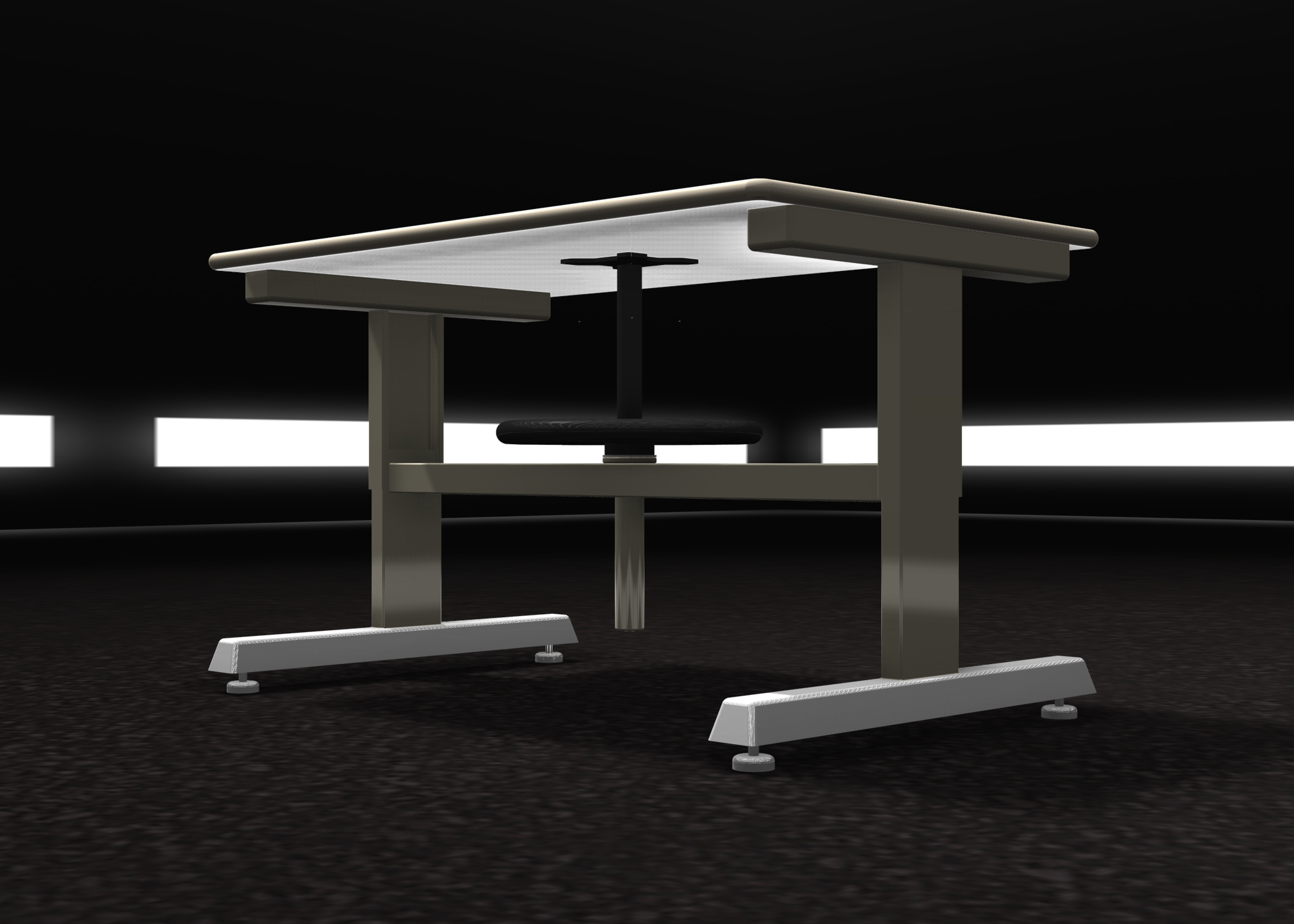

I believe this could be a very simple and economic solution for height adjustment.
The height is adjusted by spinning the wheel under the table. The threaded rod will move the table up and down. Probably the best option would be an acme threaded rod, so that it can go up and down faster.
