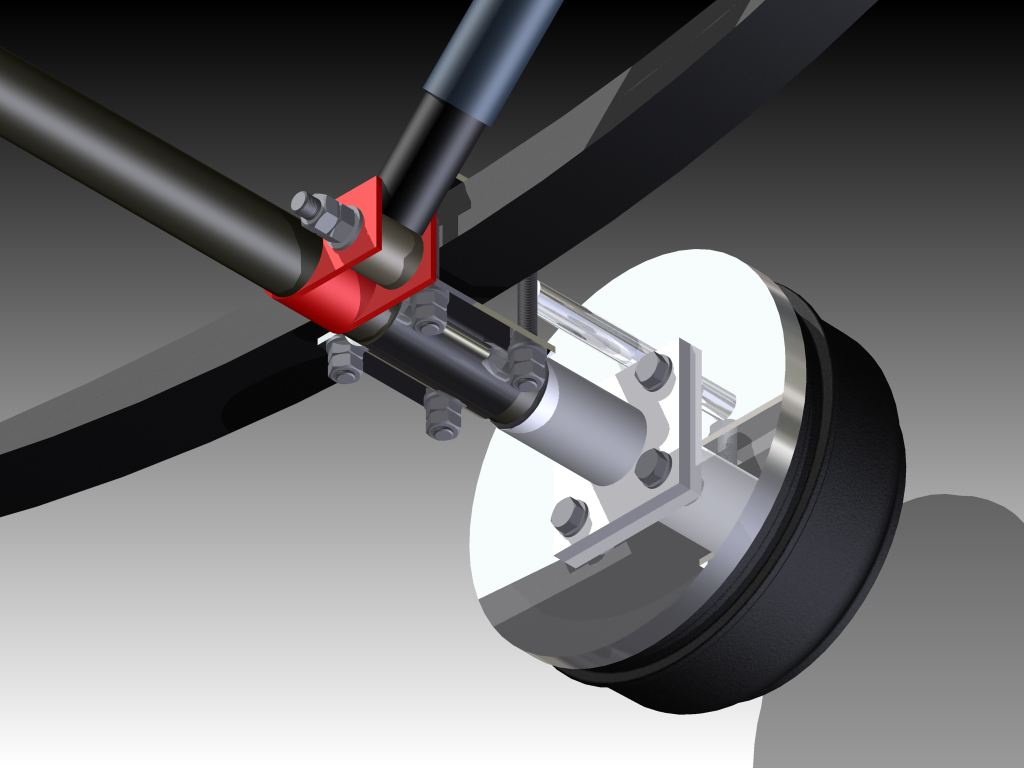

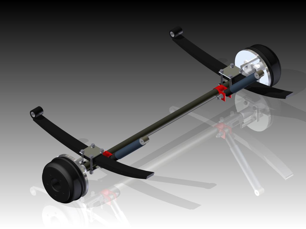

My first try.It is at an early stage of develepement so I havent tested it for strength yet as many changes need to be made.
Concept:

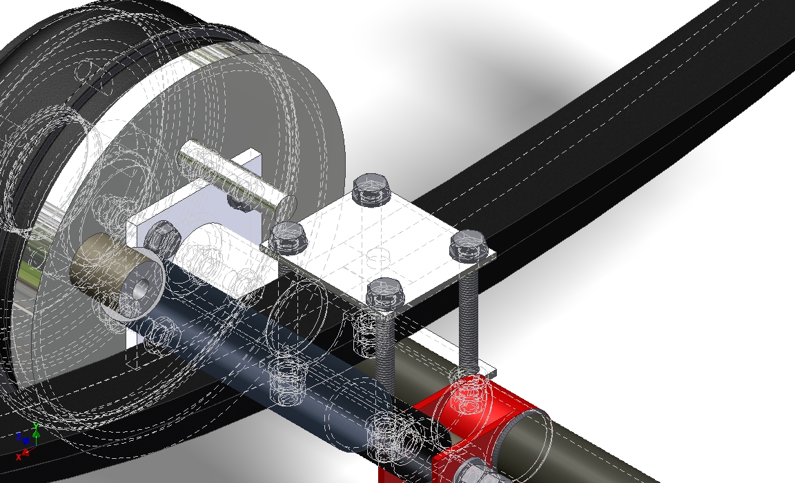

A hollow 40mm bar is used as an axis (4mm thikness), at the ends it is bolted to the hubs by the use of two connectors. Each shock absorber is bolted on a base.Each base is then welded on the axis. The leaf springs are held in place by two plates bolted together.
