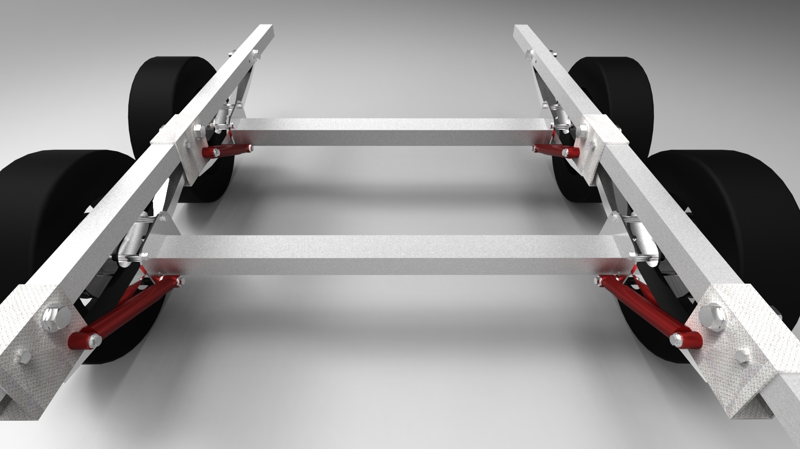

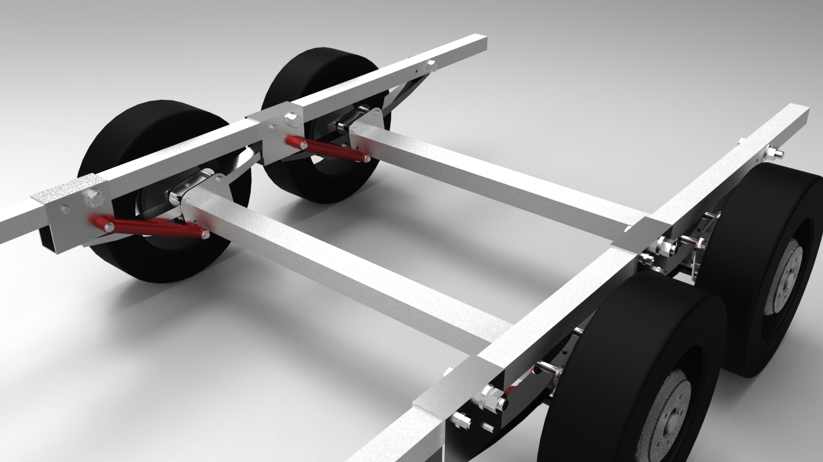

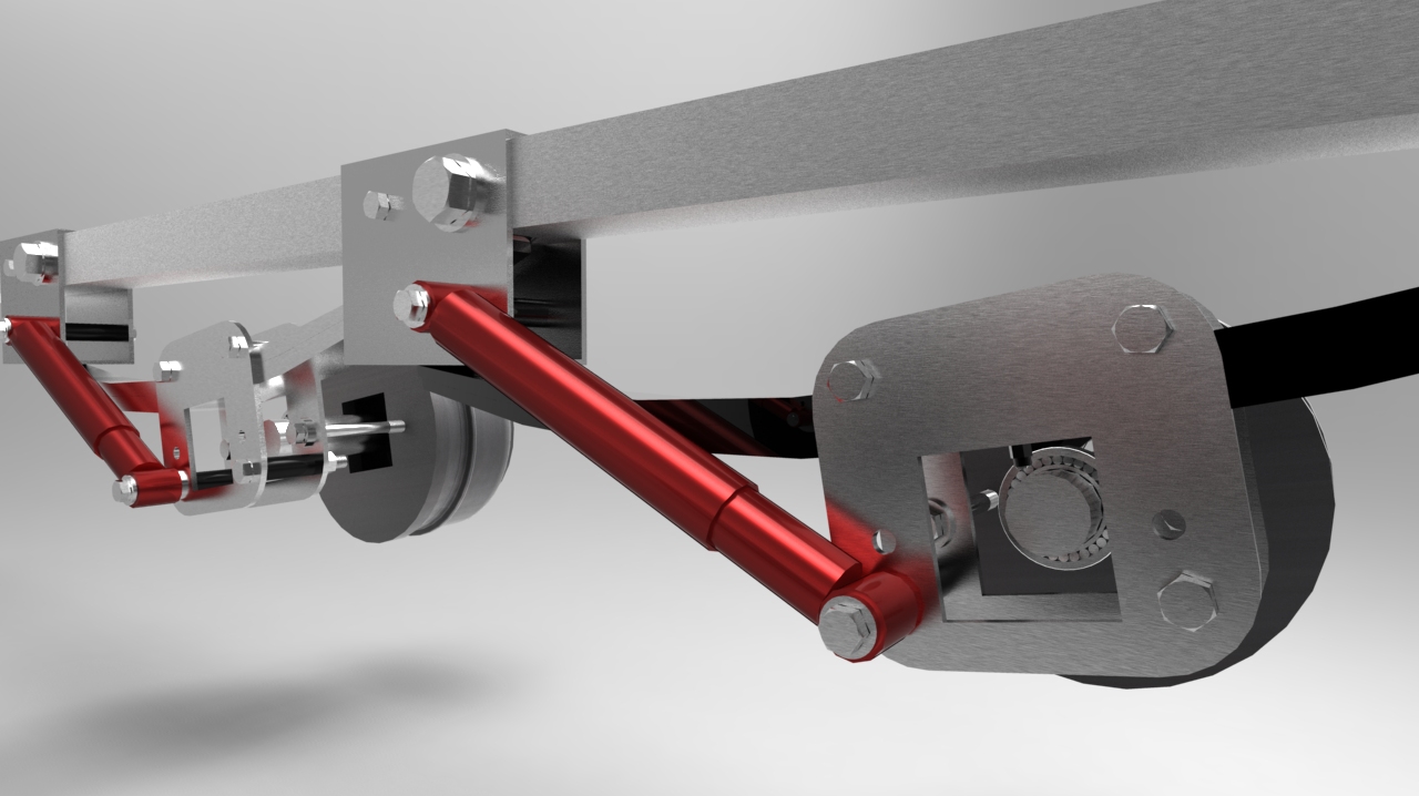

Feed Tikitrailer torsion axle design 1 By Cemal Uslu on 19 Aug 04:37
parts used:
2 square axles (75*75*6.5) which are rotated 7 degrees in installation.
laser cut 5mm support sheets (can be cut with another technologies)
4 roller bearings
4 hub axles. (needs small amount of machining)
lots of m12 m24 nuts, bolts, washers, spacers. (gonna make the nut seller richer)
no welding needed. (except stubborn nuts)
possible processes necessary:
*Laser Cutting, Hole drilling, threading, Profile cutting, hex bolt &nut tightening.
Additional washers can be needed.
lubrication can be needed on bearings and a few places.
connection sheets are not patterned however they look like they are
