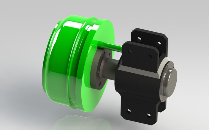

Trailer Torsion Axle design for Tikitreiler challenge.
This is my concept design, using standard buying parts, such as bearings (SKF), shaft sealing (SIMRIT) and shaft nut (MISUMI). The most complex part in this design is the pillow-block (Upright), which can be made from a single block and then machined or made from 3 parts and then welded.
PS: These colours were used to differentiate parts.

    Nice work, I havent seen too many people on here addressing the rolling part of the axle. Nice bearings! You might want to rotate the black part for add'l ground clearance.
  • Filipe Rosado
    Filipe Rosado over 1 year ago
    Thanks!!! Yes I could rotate the upright, but the axle will loose stiffness.
