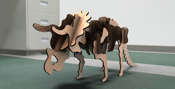

I found in http://www.blechwelt.com/teil_des_monats/archiv.htm the cut out plans of this craft and just assembled it in SW
  • Philippe Carrier
    Philippe Carrier over 1 year ago
    It looks very nice! What kind of tolerancing have you used with laser cutting? What was the material thickness?
  • J E Paz
    J E Paz over 1 year ago
    hi philippe Thanks!, on the first attempt I believe my mistake was not to consider the material thickness, thats why it was loose, the last attempt that was today actually fitted pretty well just by scaling the parts so that the grooves where as wide as the material thickness what are you planning on doing?
