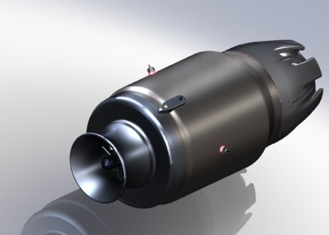

Its here, its about as finish as can be I still have a few little things to adjust but overall it 98.99 finish. I left out all fasteners and or mounting hardware to keep the file size down. Units are in Inches I have one oil line (green color tubing) and a fuel line, the glow plugs are custom. I added a heat shield between the main shaft and the combustion chamber. Oil supply to the bearings. Overall length 24" with end nozzle, without end nozzle 16.68"
I will upload a step version in a couple of days
enjoy the model this one is larger then the ones on the internet today
Info:
This is model after the KJ-66 turbine only that it is a little larger in size, combustion chamber is longer and wider in diameter
Beautiful design! Congratulations! It makes me want to build one.
But aren't the compressor stator vanes flipped? I believe concave side should face flow rotation. Same for turbine, stator should cause rotation to help turbine spin, something like this:
http://www.pointwise.com/images/app_turbo_aachen_1000px.png
