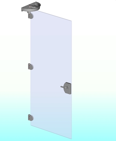

Wind breaker door brake
This design incorporates a centrifugal brake driven by a modified hinge and pin arrangement.
Normal opening of the door operates with no additional force by the crew member or passenger. In the event a high wind causes the operator to lose control, the sudden acceleration of the door will force the brake arm to swing upwards and engage the brake pad and arresting further motion.

    Maximir about 1 year ago
    Great job, Patrick! Handshake!
  • Rocco
    Rocco about 1 year ago
    It is simple, efficient with no addictional loads during the nominal behaviour of the door. Great job.
  • Patrick Hughes
    Patrick Hughes about 1 year ago
    Thank you Bruno and Rocco.
