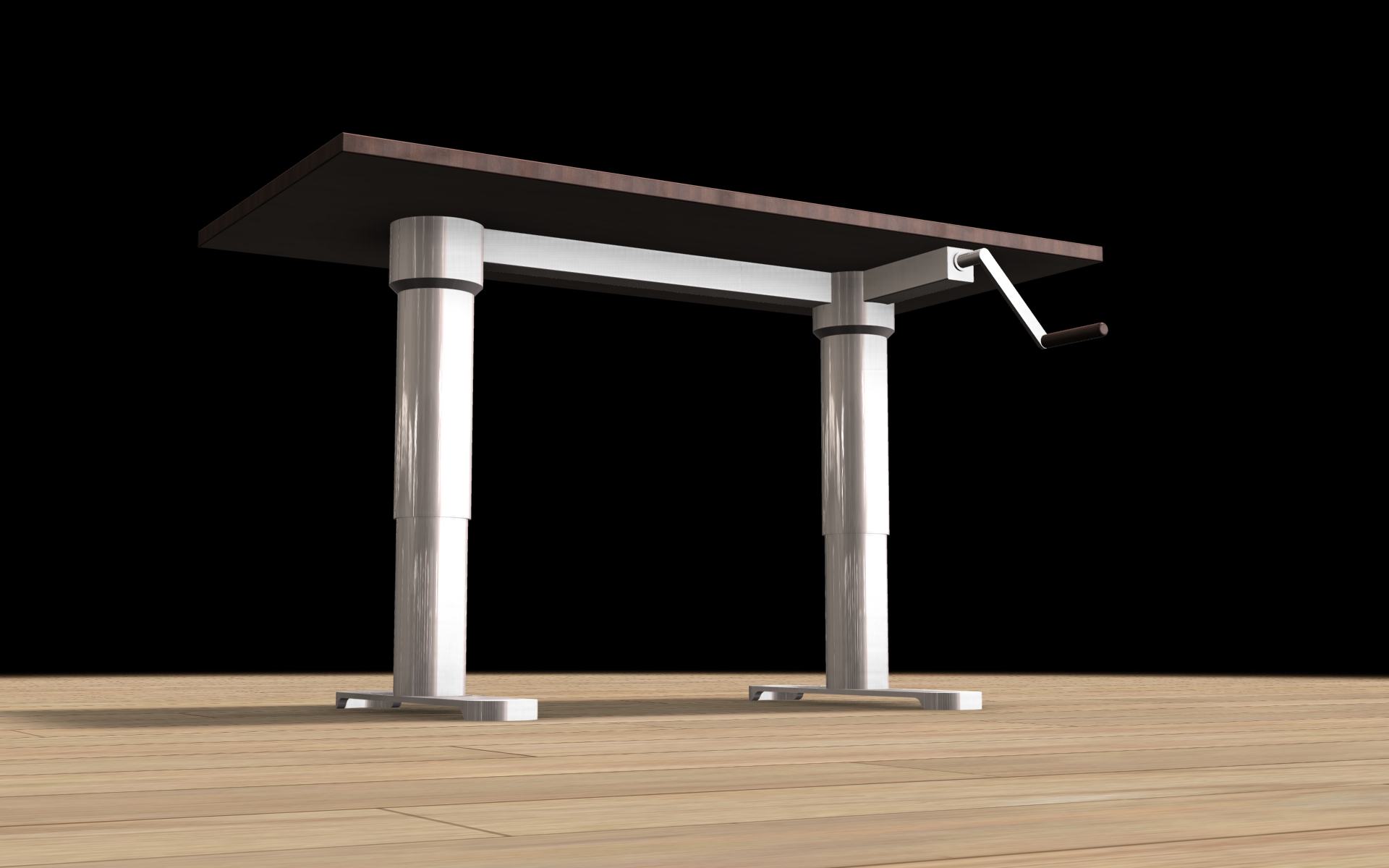

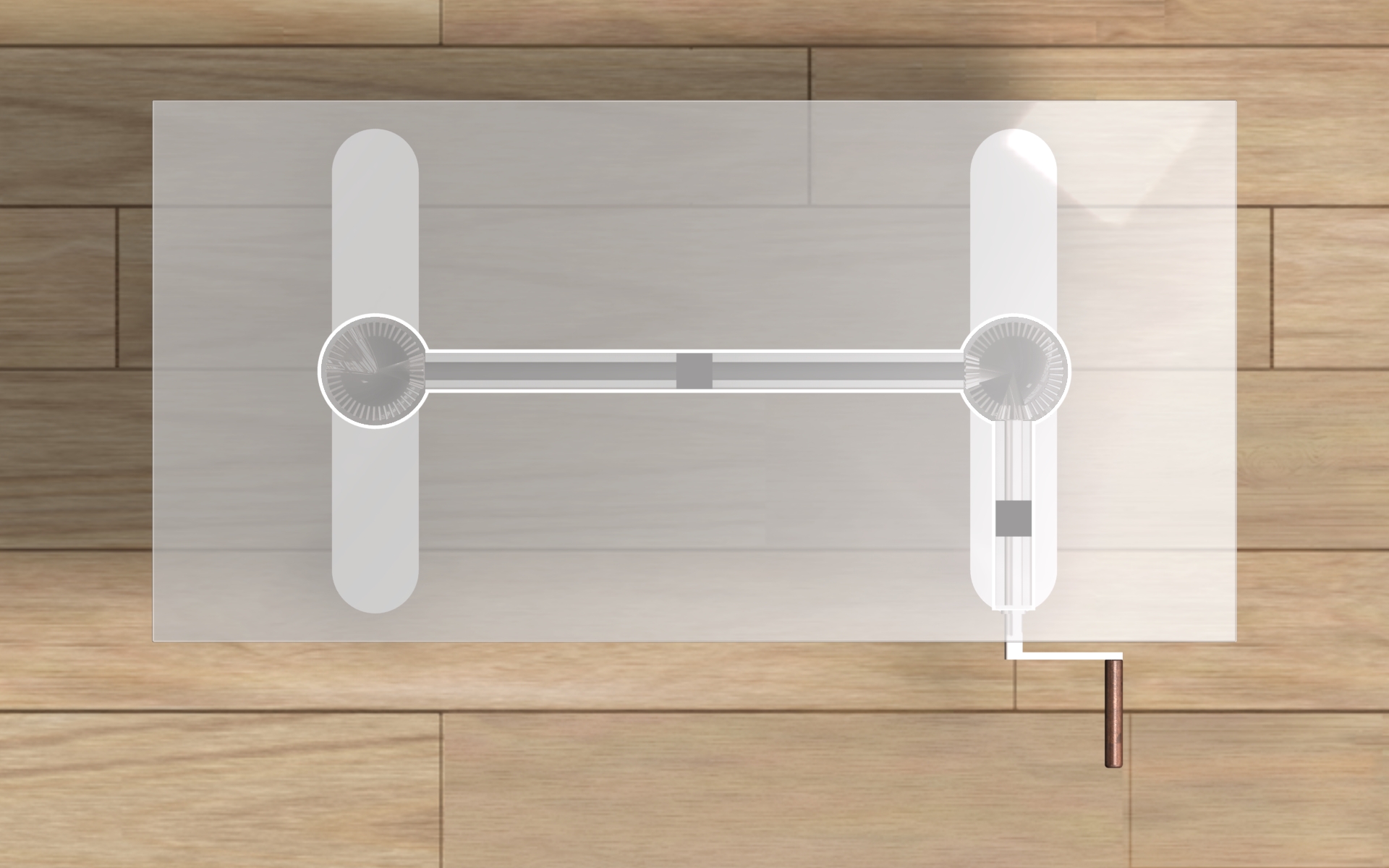

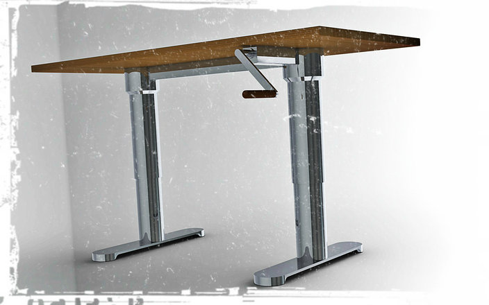

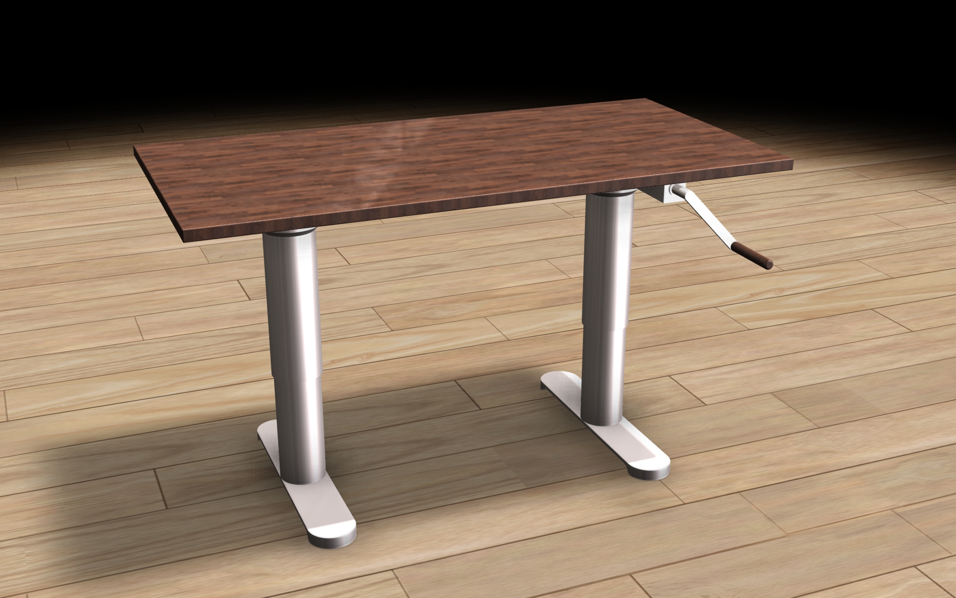

A Concept of a workbench with "spiral" cogs for height adjustment.
The idea is that with a realative small force be able to change the height of the table, and at the same time the tables mechanics cant be in the way for the daily use of the table.
The build is made up of a pair of bevel gears connected by 2 other bevel gears to connect the two legs. The "spiral" gears are connected to a bevel gear and rotates when the bevel gear rotates.
All gears can be adjusted to suit the need of speed when adjusting the height of the table.
