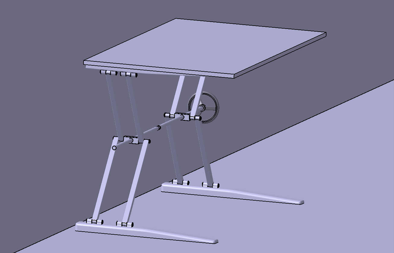

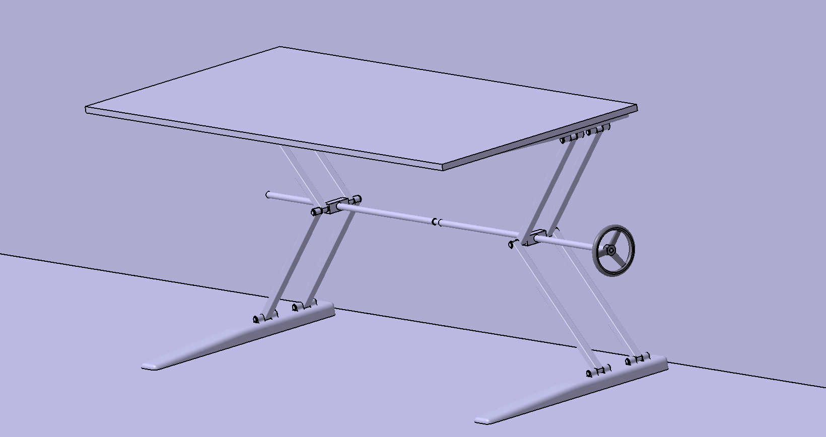

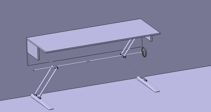

      Thanks for advice.
      I am trying to create a model that will have a minimum of different parts and machining. Now I have 11 different parts which are very easy for mounting.
      If I have enough time I will try to create a more stable and more expensive table but on this one my goal is achieved
      5 months ago
    • Chris Duncan
      Chris Duncan
      This table is not finished. It needs something to connect the lower feet together. If not connected there is nothing stopping them from swinging out to the side and the table drops to the ground.
      5 months ago
    • Andjelic Zoran
      Andjelic Zoran
      Thanks, again
