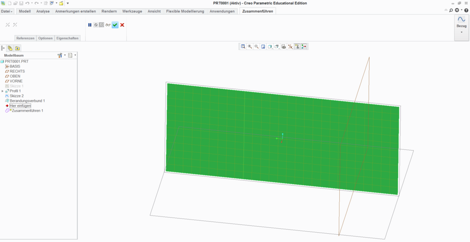

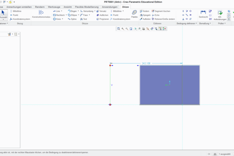

    Berkani 9 months ago

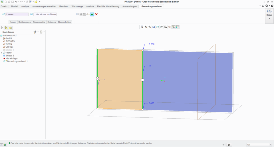

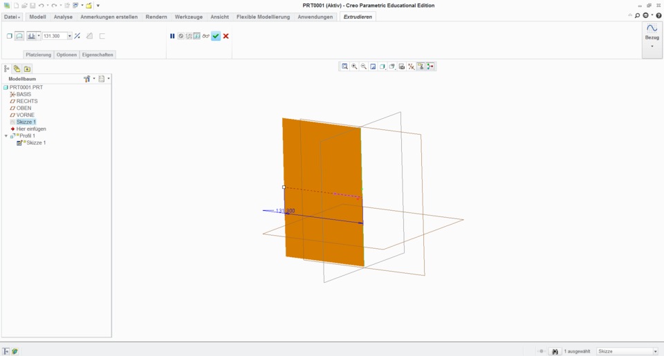

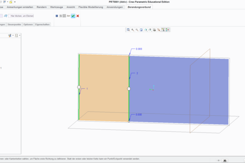

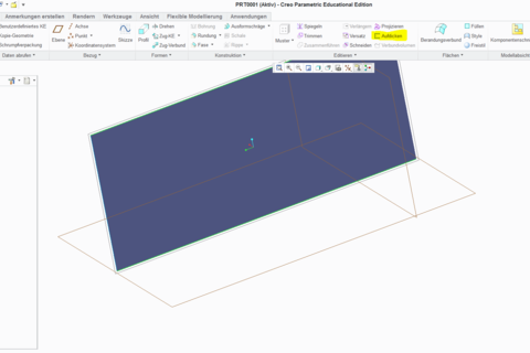

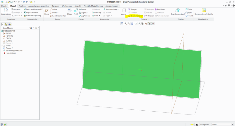

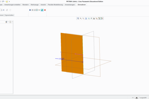

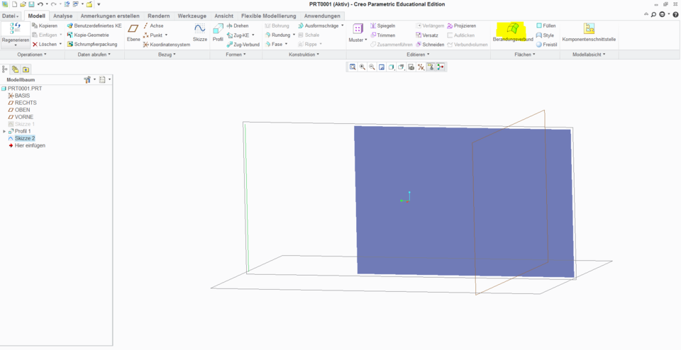

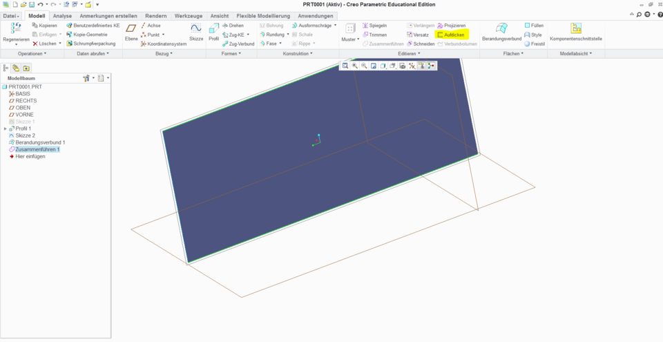

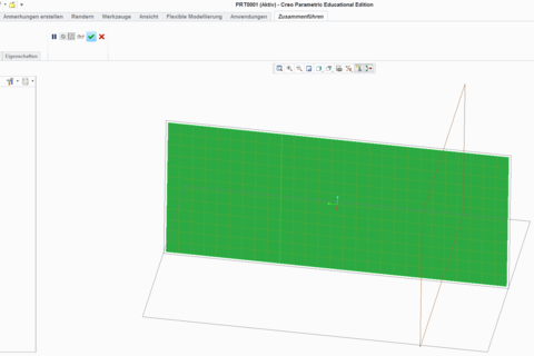

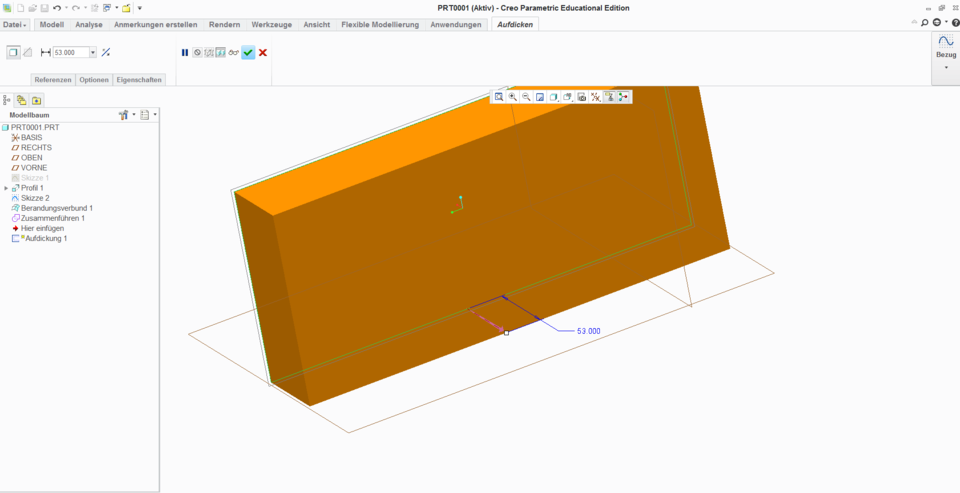

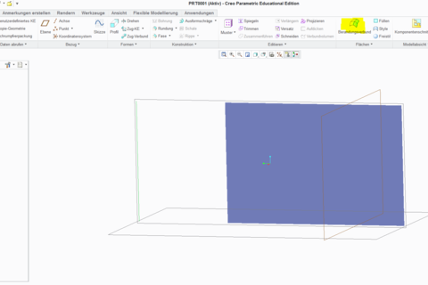

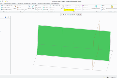

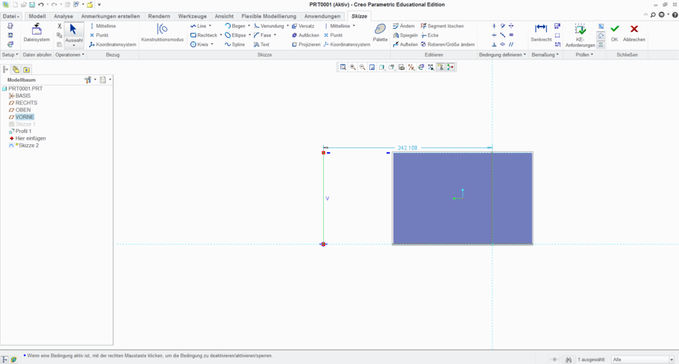

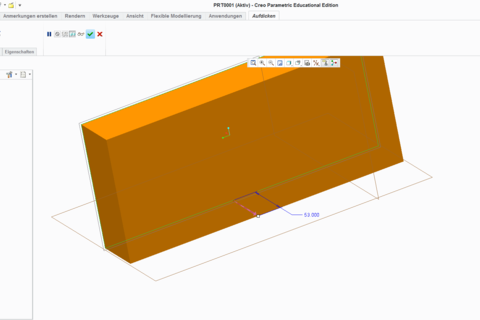

    hi, maybe this will help you, its a example haw to merge tow surfaces
    1. Step 1
      1
      Medium
    2. Step 2
      2
      Medium
    3. Step 3
      3
      Medium
    4. Step 4
      4
      Medium
    5. Step 5
      5
      Medium
    6. Step 6
      6
      Medium
    7. Step 7
      7
      Medium
    8. Step 8
      8
      Medium

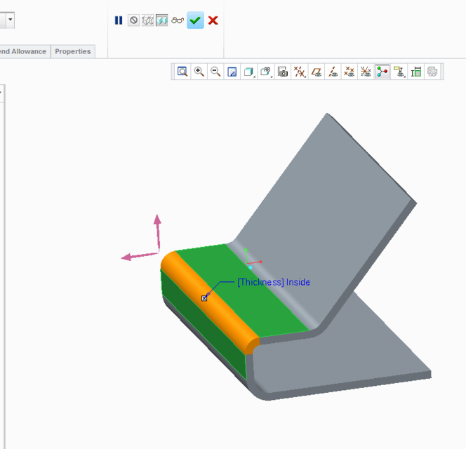

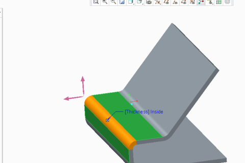

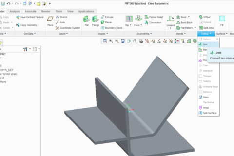

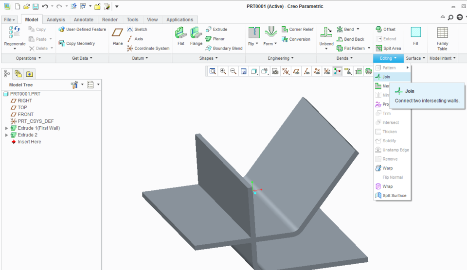

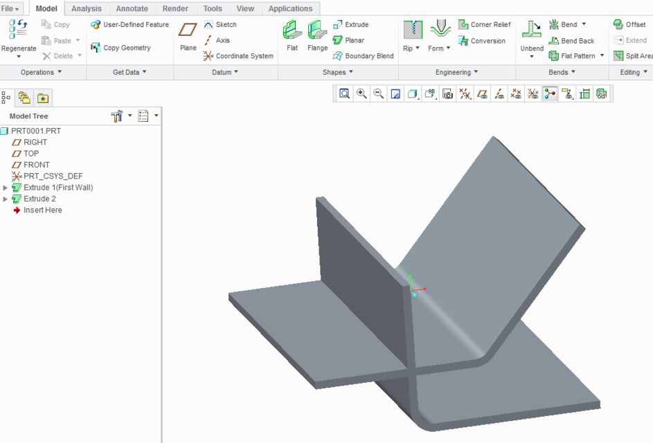

    Follow the steps below if it is a sheetmetal part.
    1. Step 1
      Create the walls as seperate features
      Medium
    2. Step 2
      Click Join under the editing group
      Medium
    3. Step 3
      Select the 2 surfaces that you want to join/merge. You can click on the arrows to flip the direction of the walls that you want to keep. Complete the feature
      Medium
