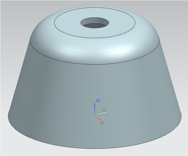

Hi,
I have done extraction for the same part ( approximate the same shape) in UG NX 7.5
and i am attaching the Video for the same and the NX file which i worked on
UG will create multiple files like core,cavity, parting surf so on
The top assembly file is " Plastic_Part_top_000.prt "

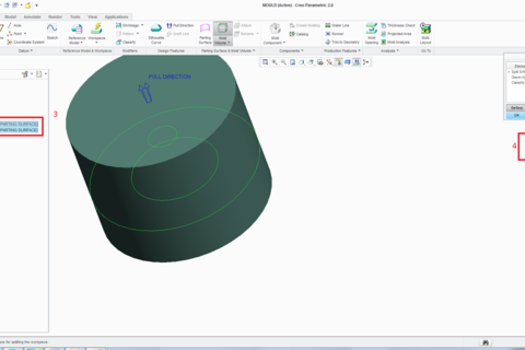

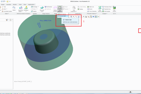

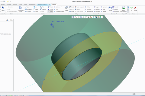

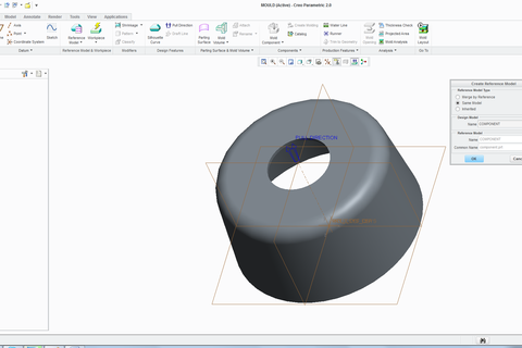

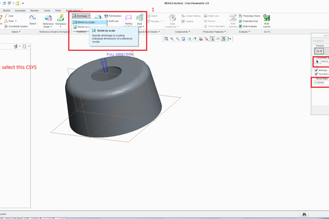

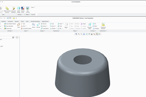

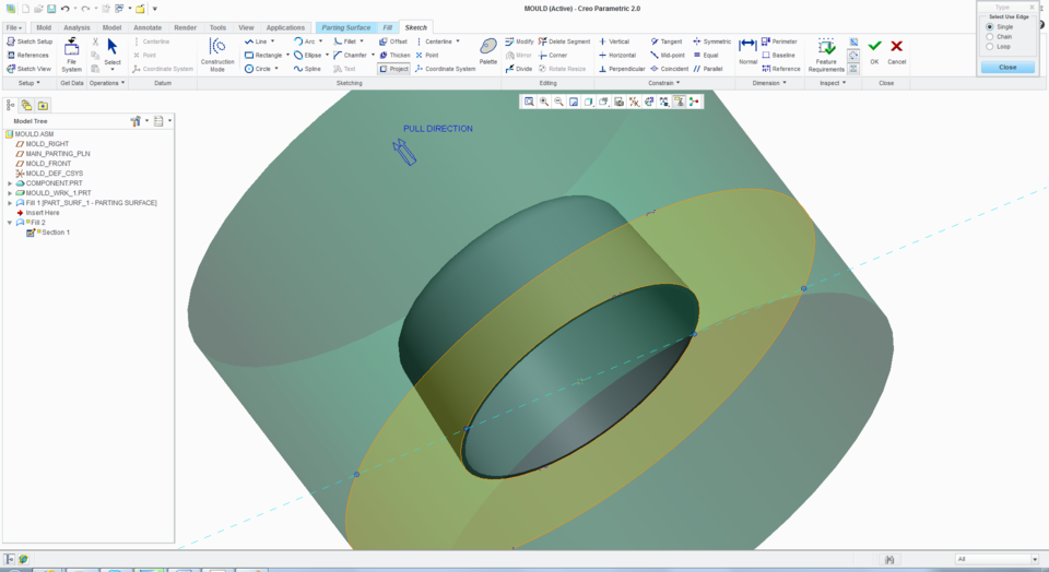

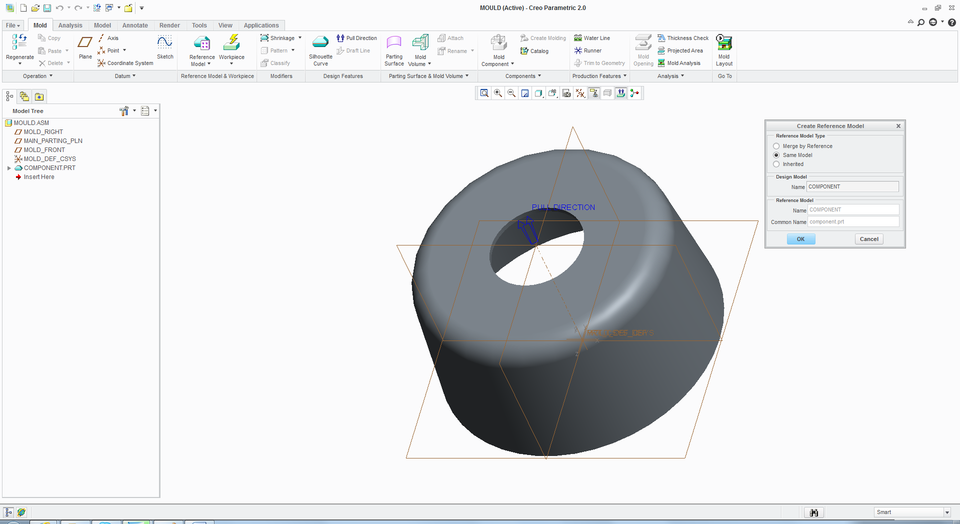

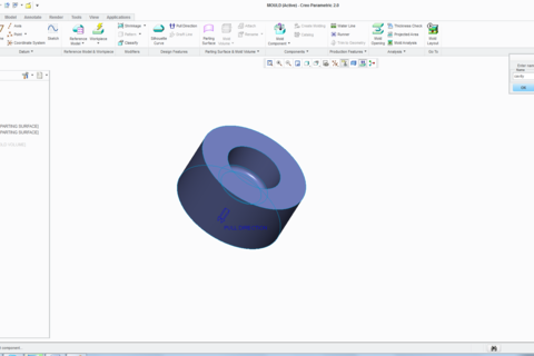

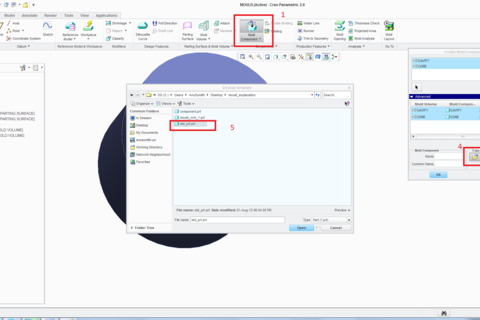

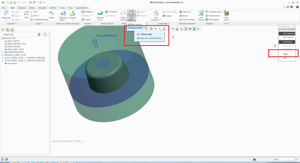

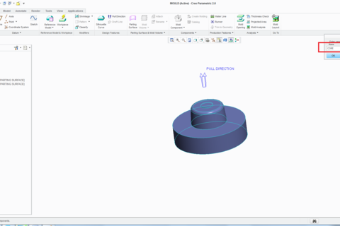

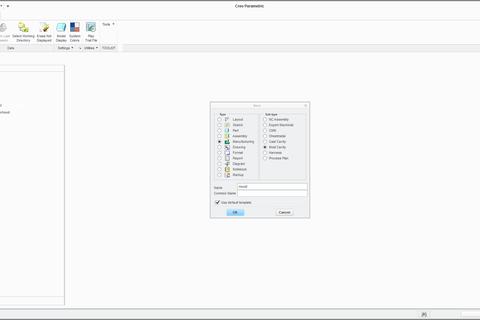

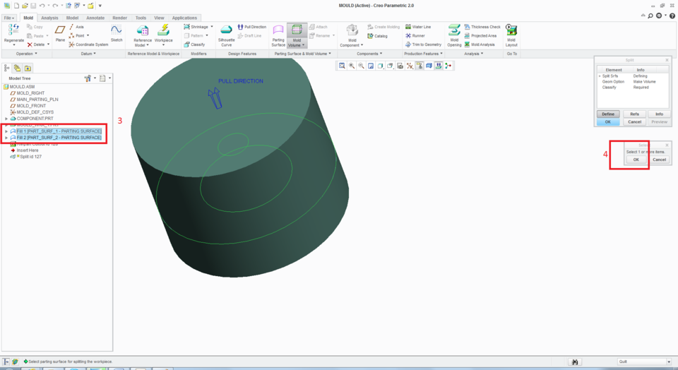

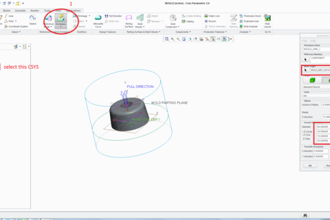

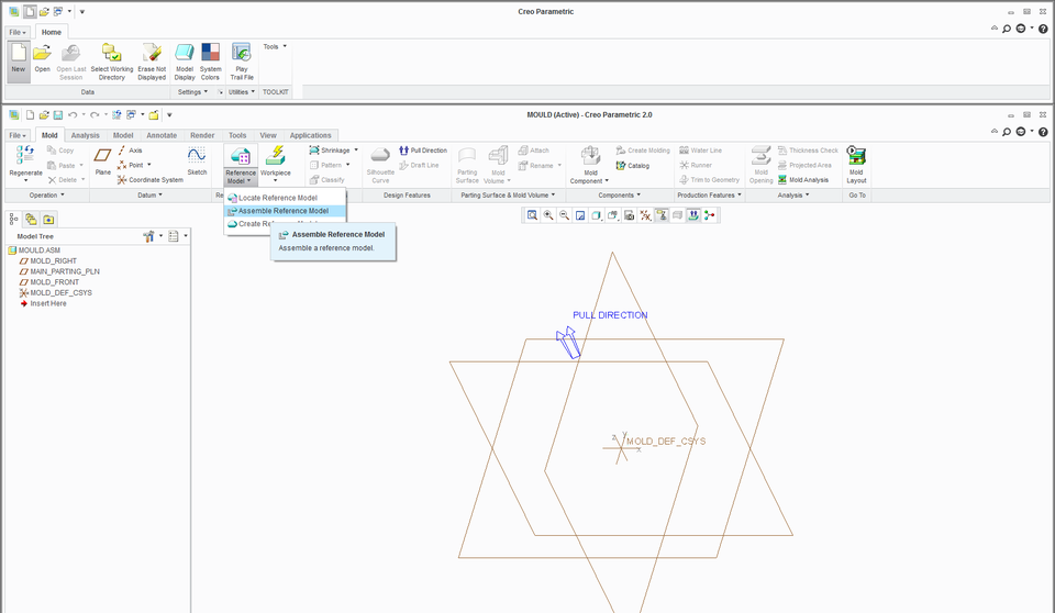

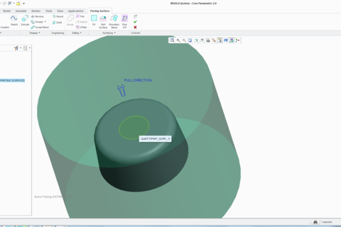

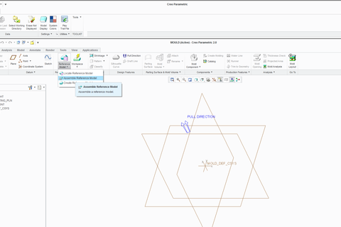

I am not that comfortable with Unigraphics, but i could help you with Creo parameteric(Latest version of Pro E), I took a simple component to explain the procedure but it needs a good understanding of moulding process to become a real expert in Core Cavity split. should understand the concepts of different parting surfaces.
Dont worry! it is not a rocket science ,
Answered with a tutorial: https://grabcad.com/tutorials/can-anybody-help-me-for-to-spilit-core-cavity-in-unigraphics-or-pro-e
