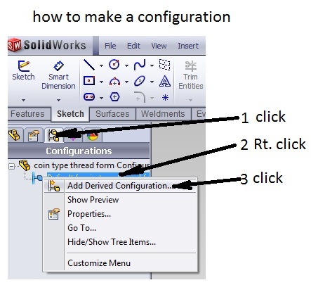

    1. Select the part you want to be the same but different (your front back panel)
    on the tree and click "Open". Or "Edit" but beware of in-context relationships.
    2. Click the configurations tab and add a configuration name it. See 1st photo.

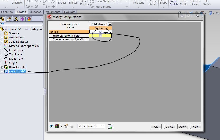

    4.right click on that (or several) feature and click "configure feature". (see 2nd photo)
    5. In this manager, suppress the feature(s) in the configuration you dont want the feature on (the cut).

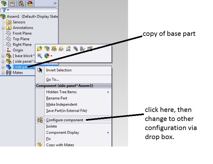

    7. Now you can copy the part (highlight cntl C in the tree) then paste the part.
    8. you should see the part at the bottom of the tree, and it should not have any mates and it will be floating. Right click this click part in the tree, hit configure feature, this time switch the drop down in the Configuration column to the other (see 3rd photo).
