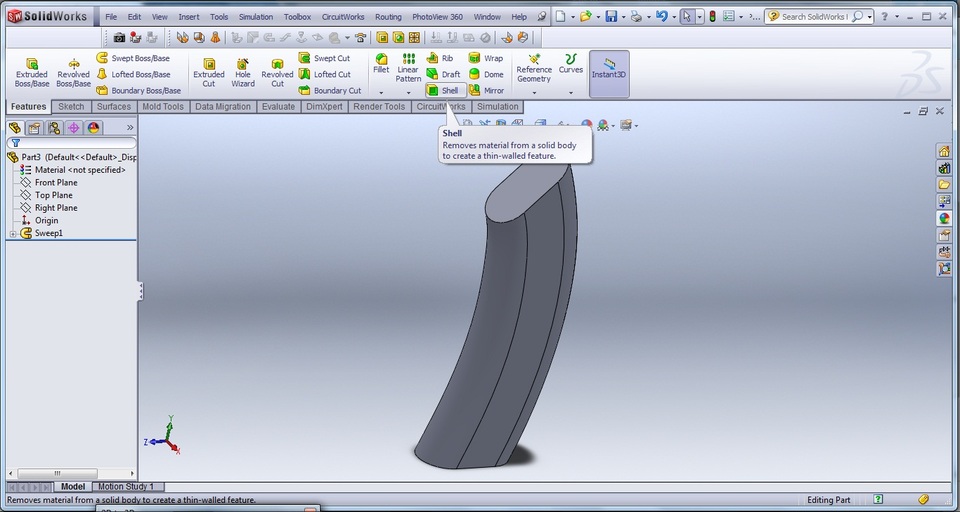

how can i hollow this part out in sw2012 and leave the top face solid? or cut an extrusion from the top to the bottom on an angle? im very new to solidworks im just messing with it. thanks

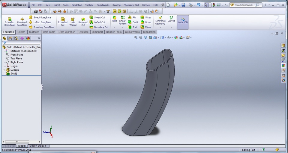

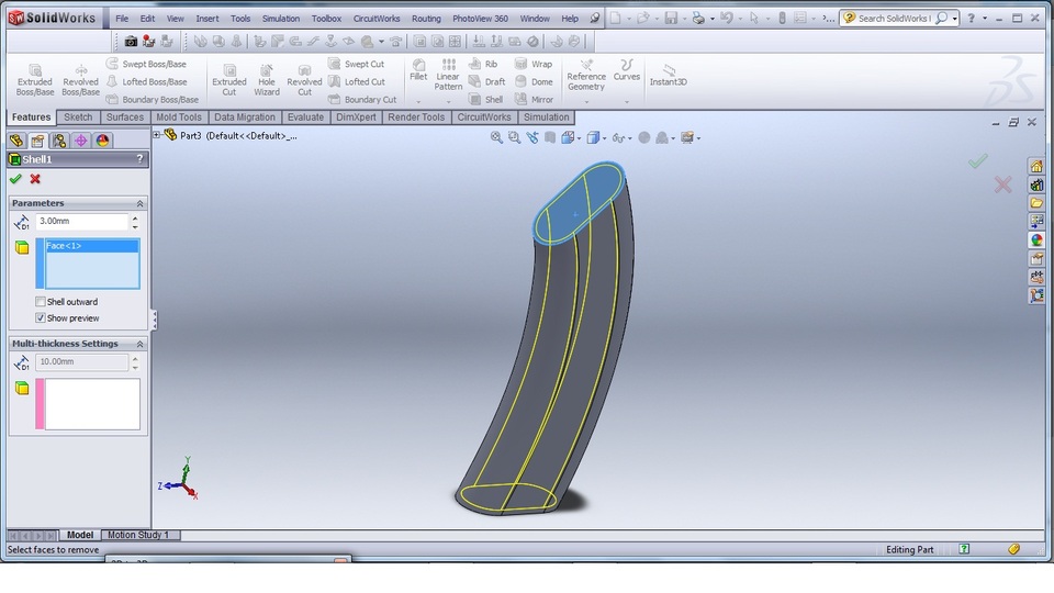

    maybe you can try Shell features :)
    Added images
