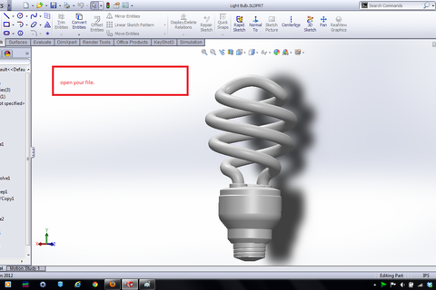

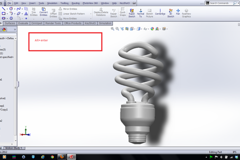

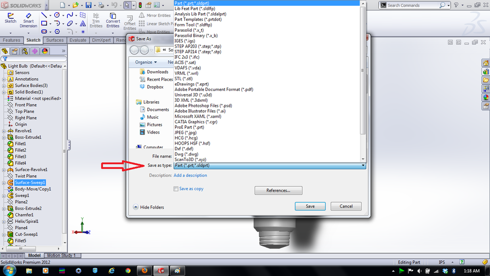

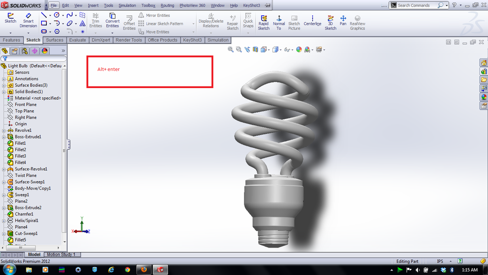

If you are using SW when you hit save as (sldprt being standard for part ) hit the down arrow right of it & it will give you many options to save your design under. If I was in front of my Pc I would take a screen shot.
Open the .sldprt file in solidworks that you want to save in any other format
Answered with a tutorial: https://grabcad.com/tutorials/how-do-i-convert-sldprt-to-step
