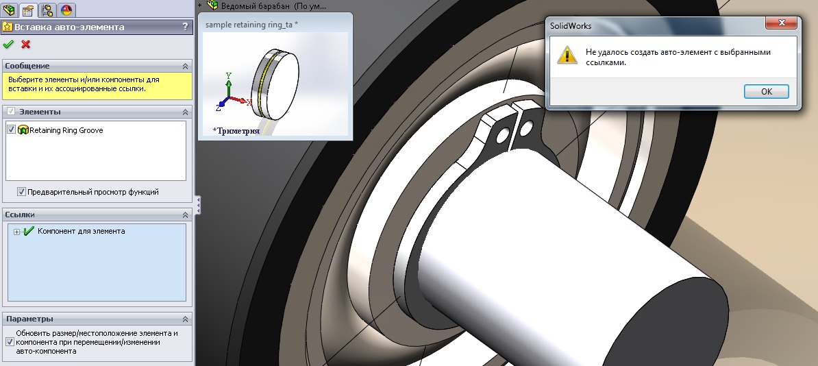

I want do something like this:
http://www.youtube.com/watch?v=sPuFaP0Me_4 (look 2.39)
But i can do this. Always error message: cant create auto features......

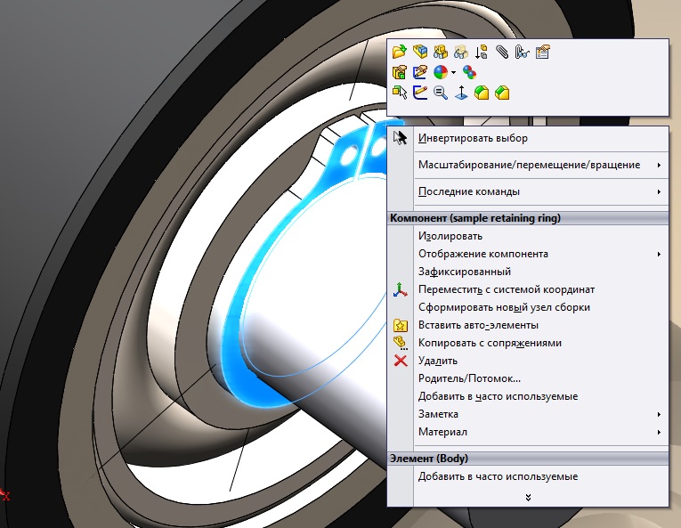

go to tools->Insert a Smart Component into an assembly and position the component with mates, exactly as you do for any other component.
Click Insert Smart Features , which appears over the component in the graphics area. a little star will appear on the components icon
A preview window appears that highlights any reference faces needed to insert the associated components or features.
Set options in the Smart Feature Insert Property Manager. and add it to library

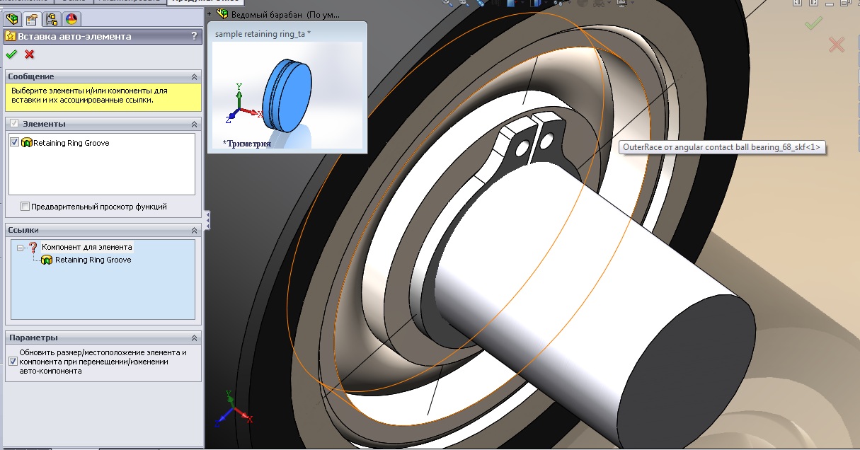

So I have to create it all myself? its about your vdeo.
Because in "MY" video its all set in the library of Solid. (2.55 min)
does feature and component make a difference for you?
