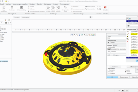

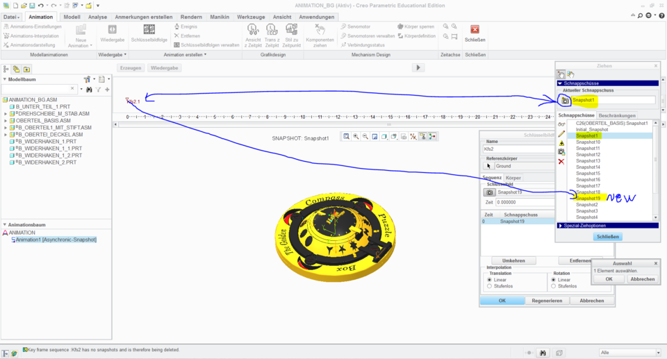

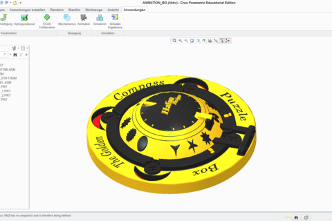

    hello, may be this will help you it´s a short exsample :)
    1. Step 1
      you have to take Snapshots of the positions you like to animat
      Medium

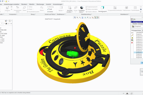

    2. Step 2
      like the Snapshot 3
      Medium

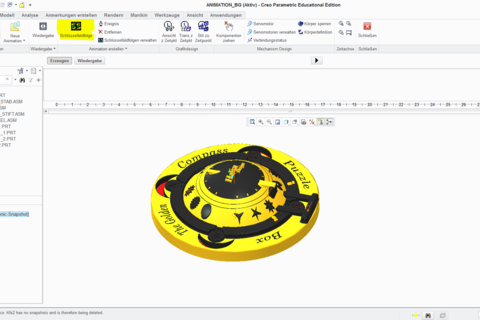

    3. Step 3
      after that you go to Animation
      Medium
    4. Step 4
      you open follow-key image ( the yellow one)
      Medium

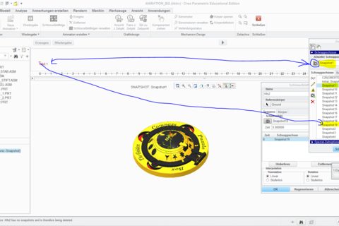

    5. Step 5
      in the step you pick the snapshot you have taken in first step
      Medium
    6. Step 6
      example , you folow this steps one by one and you do the same for the other snapshots
      Medium

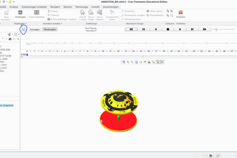

    7. Step 7
      after you've finished all of them you push play
      Medium
    8. Step 8
      and save your animation
      Medium
